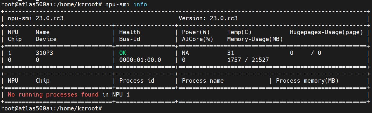

      重启后,重新登录服务器,执行如下命令查看NPU信息,如下所示:
root@atlas500ai:/home/kzroot# npu-smi info
      显示如下信息,则说明驱动安装成功。

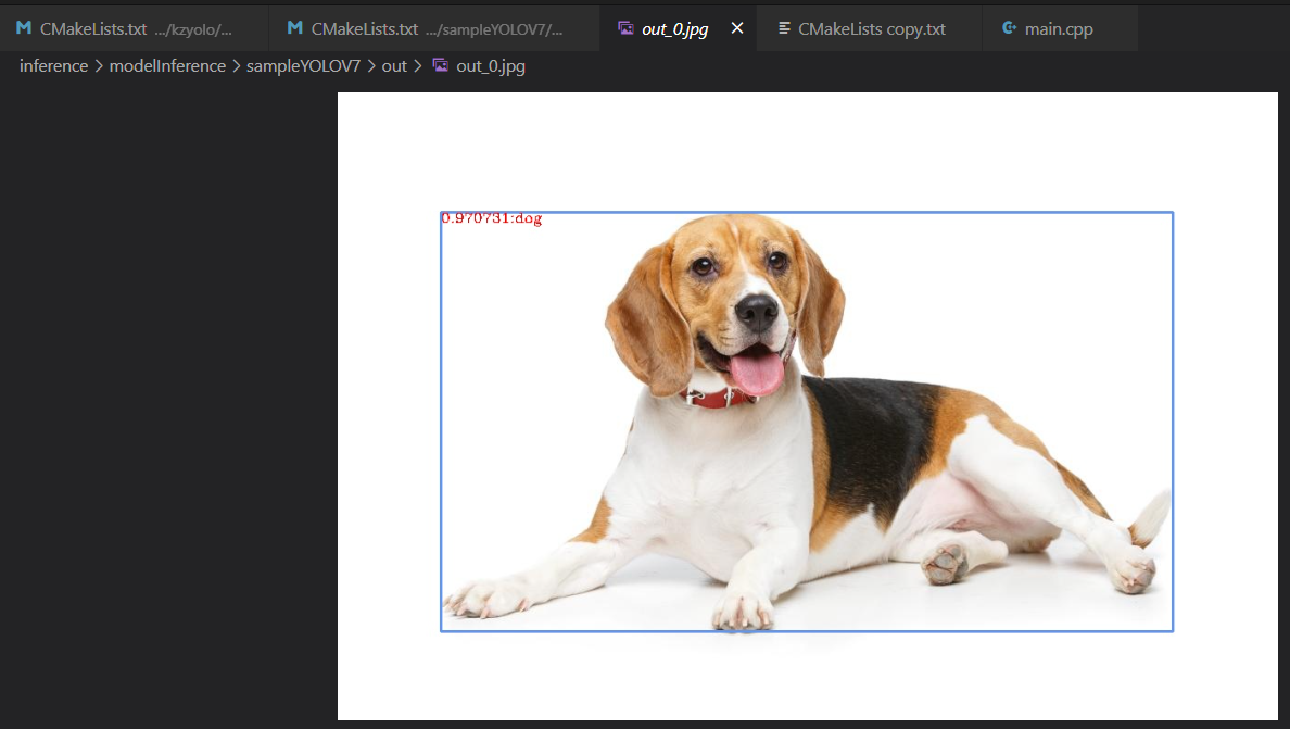

5 sampleYOLOV7样例运行
       该样例官方说明文档见https://gitee.com/ascend/samples/tree/master/inference/modelInference/sampleYOLOV7 。下面给出核心步骤:
# 下载图片
cd $HOME/samples/inference/modelInference/sampleYOLOV7/data
wget https://obs-9be7.obs.cn-east-2.myhuaweicloud.com/models/aclsample/dog1_1024_683.jpg
#模型转换
# YOLOV7原始模型转换为适配昇腾处理器的离线模型(*.om文件),放在model路径下
cd $HOME/samples/inference/modelInference/sampleYOLOV7/model
wget https://obs-9be7.obs.cn-east-2.myhuaweicloud.com/003_Atc_Models/yolov7/yolov7x.onnx
wget https://obs-9be7.obs.cn-east-2.myhuaweicloud.com/003_Atc_Models/yolov7/aipp.cfg
atc --model=yolov7x.onnx --framework=5 --output=yolov7x --input_shape="images:1,3,640,640"  --soc_version=Ascend310  --insert_op_conf=aipp.cfg
#编译
cd $HOME/samples/inference/modelInference/sampleYOLOV7/scripts
bash sample_build.sh
#运行
bash sample_run.sh
