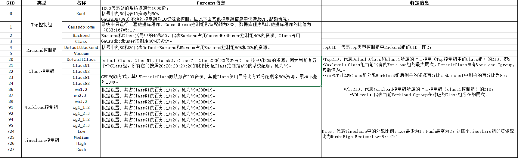

3. cgroup
GaussDB(DWS)资源负载管理的核心是资源池,而配置资源池首先要在环境中实现控制组Cgroups的设置。
Class控制组为数据库业务运行所在的顶层控制组,集群部署时会自动生成默认子Class控制组“DefaultClass”。DefaultClass的Medium控制组会含有系统触发的作业在运行,该控制组不允许进行资源修改,且运行在该控制组上的作业不受资源管理的控制,所以推荐创建新的子Class及其Workload控制组来设置资源比例。
3.1 运行脚本之后cgroup分布情况如下
per910mas@xx:~> gs_cgroup -p
Top Group information is listed:
GID:   0 Type: Top    Percent(%): 1000( 50) Name: Root                  Cores: 0-103
GID:   1 Type: Top    Percent(%):  833( 83) Name: Gaussdb:per910mas     Cores: 0-103
GID:   2 Type: Top    Percent(%):  333( 40) Name: Backend               Cores: 0-103
GID:   3 Type: Top    Percent(%):  499( 60) Name: Class                 Cores: 0-103
Backend Group information is listed:
GID:   4 Type: BAKWD  Name: DefaultBackend   TopGID:   2 Percent(%): 266(80) Cores: 0-103
GID:   5 Type: BAKWD  Name: Vacuum           TopGID:   2 Percent(%):  66(20) Cores: 0-103
Class Group information is listed:
GID:  20 Type: CLASS  Name: DefaultClass     TopGID:   3 Percent(%):  99(20) MaxLevel: 1 RemPCT: 100 Cores: 0-103
GID:  21 Type: CLASS  Name: ClassN1          TopGID:   3 Percent(%):  99(20) MaxLevel: 3 RemPCT:  60 Cores: 0-103
GID:  22 Type: CLASS  Name: ClassN2          TopGID:   3 Percent(%):  99(20) MaxLevel: 2 RemPCT:  80 Cores: 0-103
GID:  23 Type: CLASS  Name: ClassG1          TopGID:   3 Percent(%):  99(20) MaxLevel: 3 RemPCT:  60 Cores: 0-103
GID:  24 Type: CLASS  Name: ClassG2          TopGID:   3 Percent(%):  99(20) MaxLevel: 3 RemPCT:  60 Cores: 0-103
Workload Group information is listed:
GID:  86 Type: DEFWD  Name: wn1:2            ClsGID:  21 Percent(%):  19(20) WDLevel:  2 Cores: 0-103
GID:  87 Type: DEFWD  Name: wn2:3            ClsGID:  21 Percent(%):  19(20) WDLevel:  3 Cores: 0-103
GID:  89 Type: DEFWD  Name: wn3:2            ClsGID:  22 Percent(%):  19(20) WDLevel:  2 Cores: 0-103
GID:  91 Type: DEFWD  Name: wg1_1:2          ClsGID:  23 Percent(%):  19(20) WDLevel:  2 Cores: 0-103
GID:  92 Type: DEFWD  Name: wg1_2:3          ClsGID:  23 Percent(%):  19(20) WDLevel:  3 Cores: 0-103
GID:  94 Type: DEFWD  Name: wg2_1:2          ClsGID:  24 Percent(%):  19(20) WDLevel:  2 Cores: 0-103
GID:  95 Type: DEFWD  Name: wg2_2:3          ClsGID:  24 Percent(%):  19(20) WDLevel:  3 Cores: 0-103
CM Group information is listed:
Timeshare Group information is listed:
GID: 724 Type: TSWD   Name: Low              Rate: 1
GID: 725 Type: TSWD   Name: Medium           Rate: 2
GID: 726 Type: TSWD   Name: High             Rate: 4
GID: 727 Type: TSWD   Name: Rush             Rate: 8

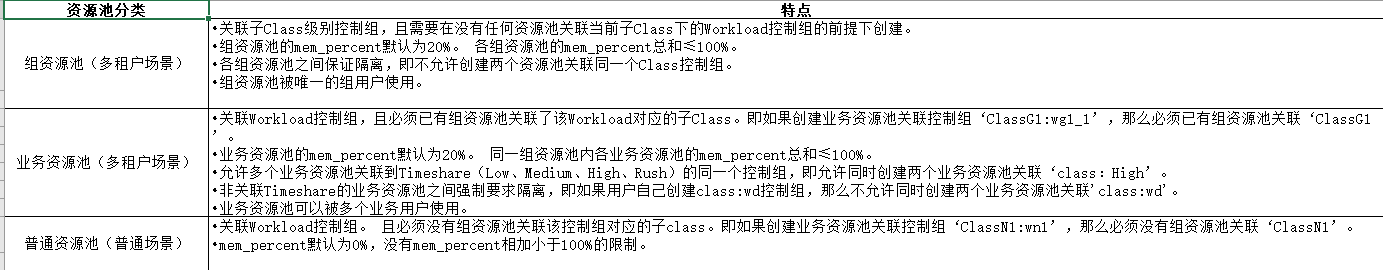

4. 资源池
4.1 资源池分布情况如下
postgres=# select oid,* from pg_resource_pool;
    oid     |   respool_name   | mem_percent | cpu_affinity |    control_group    | active_statements | max_dop | memory_limit |  parentid  | io_limits | io_priority |  nodegroup   | is_foreign | short_acc | except_rule | weight
         10 | default_pool     |           0 |           -1 | DefaultClass:Medium |                -1 |      -1 | default      |          0 |         0 | None        | installation | f          | t         | None        |     -1
 2147585814 | respool_1        |           0 |           -1 | ClassN1:wn1         |                10 |      -1 | default      |          0 |         0 | None        | installation | f          | t         | None        |     -1
 2147585815 | respool_2        |           0 |           -1 | ClassN1:wn2         |                10 |      -1 | default      |          0 |         0 | None        | installation | f          | t         | None        |     -1
 2147585816 | respool_3        |           0 |           -1 | ClassN2:wn3         |                10 |      -1 | default      |          0 |         0 | None        | installation | f          | t         | None        |     -1
 2147585817 | respool_grp_1    |          20 |           -1 | ClassG1             |                10 |      -1 | default      |          0 |         0 | None        | installation | f          | t         | None        |     -1
 2147585818 | respool_g1_job_1 |          20 |           -1 | ClassG1:wg1_1       |                10 |      -1 | default      | 2147585817 |         0 | None        | installation | f          | t         | None        |     -1
 2147585819 | respool_g1_job_2 |          20 |           -1 | ClassG1:wg1_2       |                10 |      -1 | default      | 2147585817 |         0 | None        | installation | f          | t         | None        |     -1
 2147585820 | respool_grp_2    |          20 |           -1 | ClassG2             |                10 |      -1 | default      |          0 |         0 | None        | installation | f          | t         | None        |     -1
 2147585821 | respool_g2_job_1 |          20 |           -1 | ClassG2:wg2_1       |                10 |      -1 | default      | 2147585820 |         0 | None        | installation | f          | t         | None        |     -1
 2147585822 | respool_g2_job_2 |          20 |           -1 | ClassG2:wg2_2       |                10 |      -1 | default      | 2147585820 |         0 | None        | installation | f          | t         | None        |     -1
 2147586195 | respool_4        |           0 |           -1 | ClassN2:wn3         |                10 |      -1 | default      |          0 |         0 | None        | installation | f          | t         | None        |     -1
(11 rows)
4.1.1 组资源池限制
per910mas@xx:~> gsql -d postgres -p 6000 -c  "create resource pool respool_grp_3 with (control_group = 'ClassG1');"
ERROR:  resource pool with control_group ClassG1 has been existed in the two-layer resource pool list
4.1.2 业务资源池
资源池的内存资源计算mem_percent需要按照层级进行比例计算
4.1.3 默认资源池
如果开启了资源管理功能,则系统会默认创建一个资源池default_pool。当一个会话或者用户没有指定关联的资源池时,都会被默认关联到default_pool。default_pool默认绑定DefaultClass:Medium控制组,同时并发和内存默认不管控,default_pool支持参数修改,但关联default_pool的作业会受到max_active_statements全局并发限制。当管理员执行运维操作不需要进行管控时,需要在执行SQL前执行SET session_respool=‘root’;将资源池切换至运维队列,此时作业将不受控。
