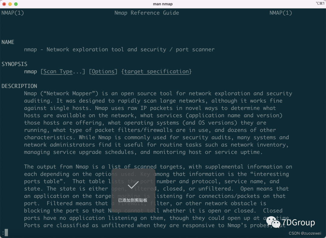

安装完成后,我们就先来看看介绍吧:
man nmap #使用此命令进行查询nmap详情
man命令还是很好用的一个说明文档帮助查看命令,就是非常详细的说明使用文档,就是这个一般是英文,估计也有人跟我一样一看英文就头大,但为了能更好的了解它,只能硬着头皮来读一遍了。为了方便我把里面主要的部分做了翻译。
NMAP(1)                            Nmap Reference Guide                            NMAP(1)
NAME
       nmap - Network exploration tool and security / port scanner
       #nmap - 网络探测工具和安全端口扫描工具
SYNOPSIS
       nmap [Scan Type...] [Options] {target specification}
DESCRIPTION
       Nmap (“Network Mapper”) is an open source tool for network exploration and security
       auditing. It was designed to rapidly scan large networks, although it works fine
       against single hosts. Nmap uses raw IP packets in novel ways to determine what
       hosts are available on the network, what services (application name and version)
       those hosts are offering, what operating systems (and OS versions) they are
       running, what type of packet filters/firewalls are in use, and dozens of other
       characteristics. While Nmap is commonly used for security audits, many systems and
       network administrators find it useful for routine tasks such as network inventory,
       managing service upgrade schedules, and monitoring host or service uptime.
       #Nmap(Nmap是"Network Mapper"的缩写)是一款免费开源的网络探测和安全审核工具,不但在单个主机里也是很好用的,在大型网络中也是很好用的,其实它设计的目标就是快速地扫描大型网络。nmap以新颖的方式使用原始IP包来确定主机在网络上可用,什么服务(应用程序名称和版本),正在运行的主机提供什么操作系统(和操作系统的版本) ,过滤/防火墙正在使用什么类型的数据包等等其他特点。虽然nmap通常用于安全审计,但许多系统和网络管理员发现在日常工作中使用它也是非常好用的,如:网络清点、管理服务升级计划以及监控主机或服务正常运行时间等。
