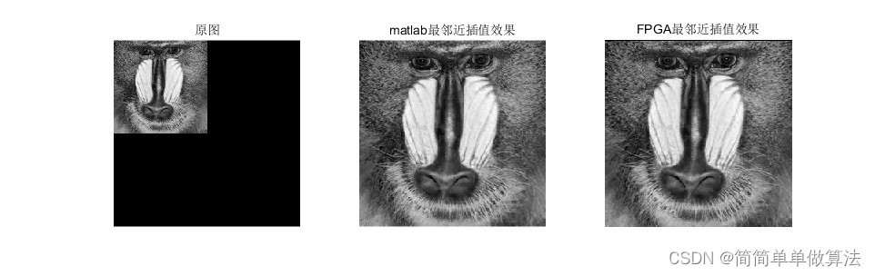

1.算法运行效果图预览
将FPGA数据导入matlab显示图片,效果如下:

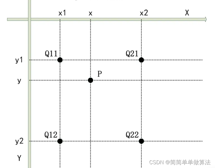

        最近邻插值,是指将目标图像中的点,对应到源图像中后,找到最相邻的整数点,作为插值后的输出。如下图所示:
        目标图像中的某点如果投影到原图像中的位置为点P,则此时取P最邻近点Q11,即 f ( P ) = f ( Q 11 ) f(P)=f(Q11) f(P)=f(Q11)。

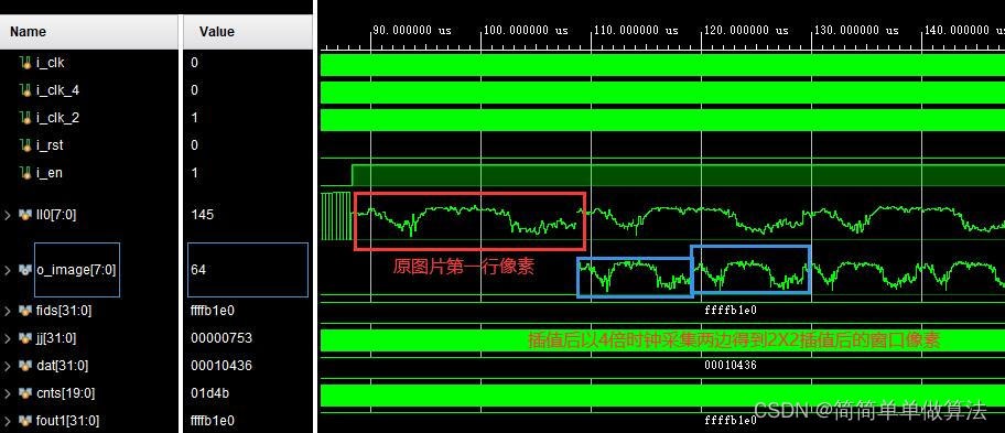

4.部分核心程序

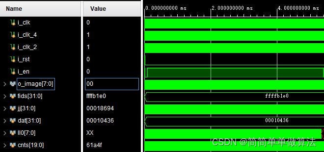

module test_image;
reg i_clk;
reg i_clk_4;
reg i_clk_2;
reg i_rst;
reg i_en;
reg [7:0] image_buff [0:100000];
wire [7:0] o_image;
integer fids,jj=0,dat;
//D:\FPGA_Proj\FPGAtest\codepz
initial
begin
	fids = $fopen("D:\\FPGA_Proj\\FPGAtest\\code\\data.bmp","rb");
	dat  = $fread(image_buff,fids);
	$fclose(fids);
end
initial
begin
i_clk=1;
i_clk_4=1;
i_clk_2=1;
i_rst=1;
#2000;
i_rst=0;
end
always #40  i_clk=~i_clk;
always #10  i_clk_4=~i_clk_4;
always #20  i_clk_2=~i_clk_2;
reg [7:0] II0;
always@(posedge i_clk)
begin
     if(i_rst)
     begin
	 II0<=0;
	 jj<=0;
     end
     else
     begin
     if(jj<=66536+1078 & jj>=1079)
     i_en<=1'b1;
     else
     i_en<=1'b0;
	 II0<=image_buff[jj];
	 jj<=jj+1;
	 end
end
tops tops_u(
.i_clk              (i_clk),
.i_clk_4            (i_clk_4),
.i_clk_2            (i_clk_2),
.i_rst              (i_rst),
.i_en               (i_en),
.i_I0               (II0),
.o_image            (o_image)
reg[19:0]cnts;
always @(posedge i_clk_4 or posedge i_rst)
begin
     if(i_rst)
     begin
         cnts<=20'd0;
     end
else begin
         cnts<=cnts+20'd1;
     end
end
integer fout1;
integer fout2;
initial begin
  fout1 = $fopen("flager.txt","w");
end
always @ (posedge i_clk_4)
 begin
    if(cnts <= 66514*4)
    begin
	$fwrite(fout1,"%d\n",o_image);
	end
	else
    begin
	$fwrite(fout1,"%d\n",0);
	end
end
endmodule
