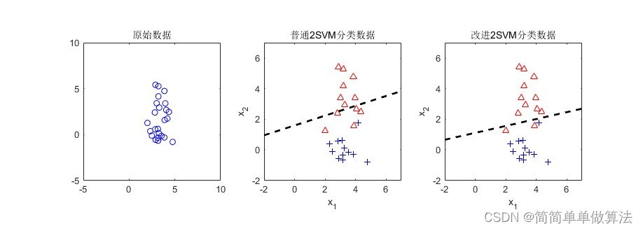

1.算法运行效果图预览

4.部分核心程序
figure;
subplot(131);
for i = 1:Class_Num
    %测试数据设置为1维,2维,或者3维,多维测试数据不方便观察
    Nums= 10+round(Num*rand(1))+1;
    Xo  = 3.2*floor((i+1)/2) + randn(1,Nums);
    Yo  = 3.2*mod(i,2)       + randn(1,Nums);
    Lo  = (2*(i-1)-1)*ones(1,Nums);
    Xt  = [Xt,Xo];
    Yt  = [Yt,Yo];
    Lt  = [Lt,Lo];
    plot(Xo,Yo,colors{1});
    hold on;
end
title('原始数据');
Test_Dat = [Xt;Yt];
Category = Lt;
axis square;
axis([-5,10,-5,10]);
%普通2SVM
%普通2SVM
subplot(132);
x       = Test_Dat;
y       = Category;
[w1,b1] = func_2svm(x,y);
title(['普通2SVM分类数据']);
axis square;
%论文算法的2SVM
%论文算法的2SVM
subplot(133);
x       = Test_Dat;
y       = Category;
[w2,b2] = func_2svm_new(x,y);
title(['改进2SVM分类数据']);
axis square;
