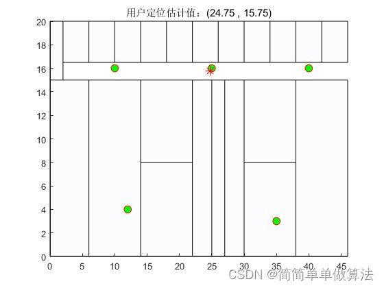

       在定位阶段,移动设备会实时采集当前位置的WIFI信号强度信息,然后将这些信息与指纹数据库中的记录进行匹配,以估计当前位置。

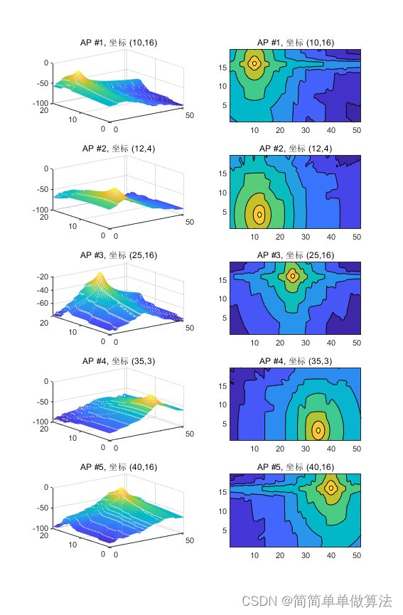

%计算每个参考点的接收功率
Pr=[];
for i=1:length(Refx1)
    i
    for j=1:length(Refy1)
        XYref=[Xref(i,j),Yref(i,j)];
        for k=1:size(AP_pos,1)
            xy_AP    = AP_pos(k,:);
            dist     =(XYref(1)-xy_AP(1))^2+(XYref(2)-xy_AP(2))^2+(H_wif-3)^2;
            Nums     = func_wallloss(house,xy_AP,XYref);
            pathloss = func_indoorloss(sqrt(dist),Ref_distance,Nums);
            Pr(i,j,k)= 20-pathloss;
        end
    end
    XYref=[Xref(i,j) Yref(i,j)];
end

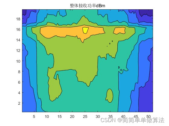

figure
subplot(5,2,1);
mesh(Xref,Yref,Pr(:,:,1));
title(['AP #' num2str(1) ', 坐标 (' num2str(AP_pos(1,1)) ',' num2str(AP_pos(1,2)) ')'])
subplot(5,2,2);
contourf(Xref,Yref,Pr(:,:,1));
subplot(5,2,3);
mesh(Xref,Yref,Pr(:,:,2));
title(['AP #' num2str(2) ', 坐标 (' num2str(AP_pos(2,1)) ',' num2str(AP_pos(2,2)) ')'])
subplot(5,2,4);
contourf(Xref,Yref,Pr(:,:,2));
subplot(5,2,5);
mesh(Xref,Yref,Pr(:,:,3));
title(['AP #' num2str(3) ', 坐标 (' num2str(AP_pos(3,1)) ',' num2str(AP_pos(3,2)) ')'])
subplot(5,2,6);
contourf(Xref,Yref,Pr(:,:,3));
subplot(5,2,7);
mesh(Xref,Yref,Pr(:,:,4));
title(['AP #' num2str(4) ', 坐标 (' num2str(AP_pos(4,1)) ',' num2str(AP_pos(4,2)) ')'])
subplot(5,2,8);
contourf(Xref,Yref,Pr(:,:,4));
subplot(5,2,9);
mesh(Xref,Yref,Pr(:,:,5));
title(['AP #' num2str(5) ', 坐标 (' num2str(AP_pos(5,1)) ',' num2str(AP_pos(5,2)) ')'])
subplot(5,2,10);
contourf(Xref,Yref,Pr(:,:,5));
figure
contourf(Xref,Yref,sum(Pr,3));
title('整体接收功率dBm')
