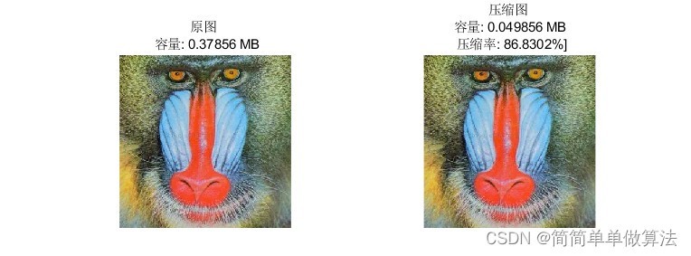

1.算法运行效果图预览

figure;
Isize1      = imfinfo(Names).FileSize;
Isize2      = (Isize1*(sum(Lens(:))/3))/8;
CmpRates    = 100*((Isize1 - Isize2)/Isize1);
subplot(1,2,1);
imshow(I0);
title(sprintf("原图 \n 容量: "+ Isize1/(1024*1024) + " MB"));
subplot(1,2,2);
imshow(Iout);
title(sprintf("压缩图 \n 容量: "+ Isize2/(1024*1024) + " MB \n 压缩率: "+CmpRates+"%%]"));
