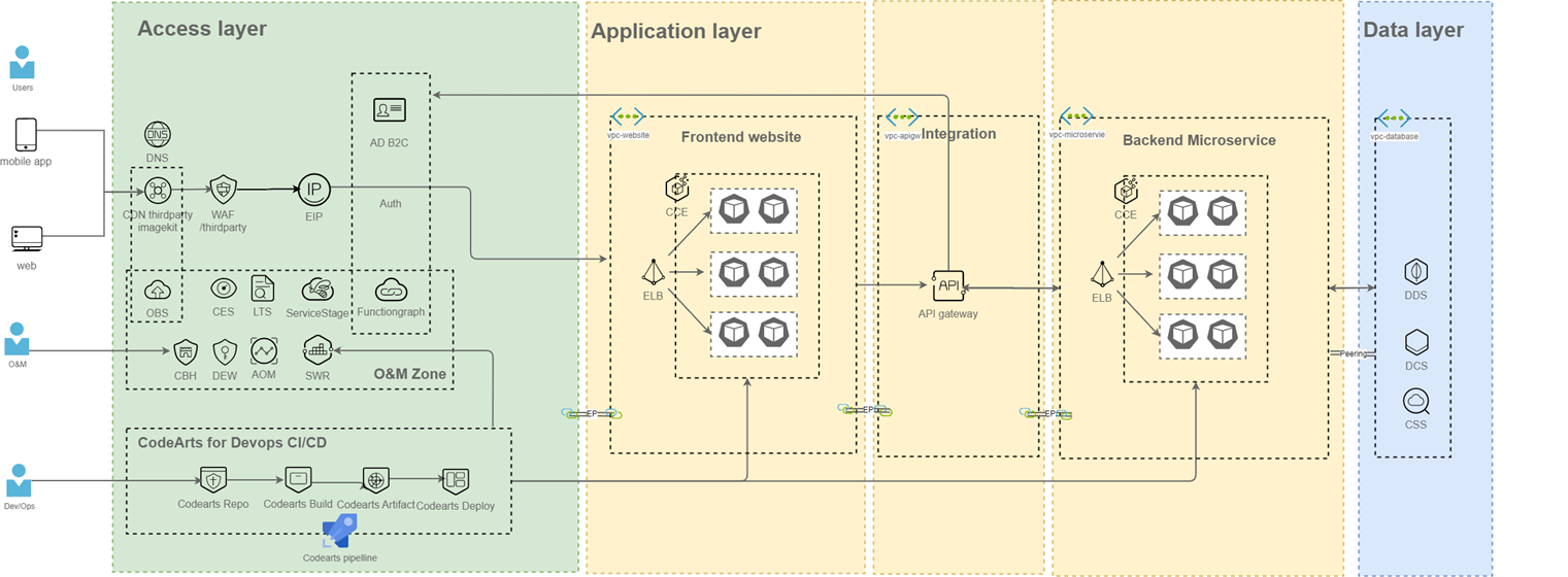

Orel IT’s Pipleline Design and using issues and DTSE customize the pipeline:
The Orel Buy system code of Orel IT is on the Azure pipeline. There are XX microservices. The front end uses the TS language and is deployed on VMs. The backend also uses the TS language and is deployed on containers.
For commercial code migration, DTSE and Orel IT developers analyze the code release process of Orel Buy, including Boards, Repos, Pipelines, Test Plans, and Artifacts. There are many customized steps and commands in the Orel IT pipeline. For example, the Orel IT code has customized commands for code build, code check has customized rules, and code needs to be released to different environments using the same pipeline. DTSE configures CodeArts-based pipelines based on Orel IT requirements, including CodeArts check, build, and deploy commands. Finally, DTSE helped the customer configure the first pipeline, and after the customer's business code was migrated, the website initially failed to run. After debugging and log analysis by DTSE and the customer, it is found that the back-end port on the customer service side is not enabled. During the migration, customers also find that CodeArts products are easy to use. For example, CI/CD Pipelines can be directly configured on the CodeArts page, and SWR images can be pulled and run during container deployment.
Although Orel IT has many microservices, the overall architecture is very clear. The front end is deployed on VMs, and the back end is deployed on containers. DTSE and the customer analyze together and finally configure two pipelines: one is the front-end pipeline and the other is the back-end pipeline. The front-end pipeline uses the req, check, build, artifact, test, and deploy functions of CodeArts and works with ECSs to deploy the pipeline. The backend pipeline uses the req, check, build, artifact, test, and deploy functions of CodeArts and works with CCE to deploy the pipeline. The customer's commercial code successfully uses CodeArts pipelines and runs successfully.
