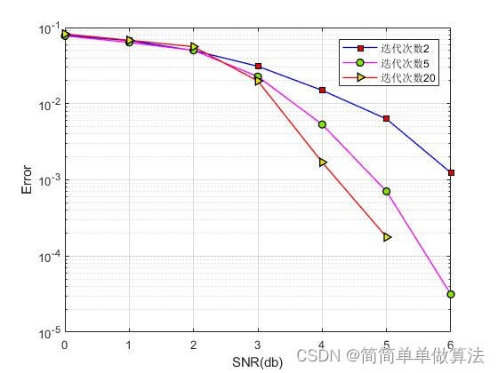

1.算法运行效果图预览

figure;
semilogy(EbNo,BERs,'r-o');
grid on;
if IN_Iter==2
   save R1.mat  EbNo BERs
end
if IN_Iter==5
   save R2.mat  EbNo BERs
end
if IN_Iter==20
   save R3.mat  EbNo BERs
end
