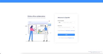

Note: Enter http://ip:11001 in your browser to access the PC Web. This IP should be the server’s OPENIM_IP to ensure browser accessibility. For first-time use, please register using your mobile phone number, with the default verification code being 666666.
Image: PC Web Interface Example

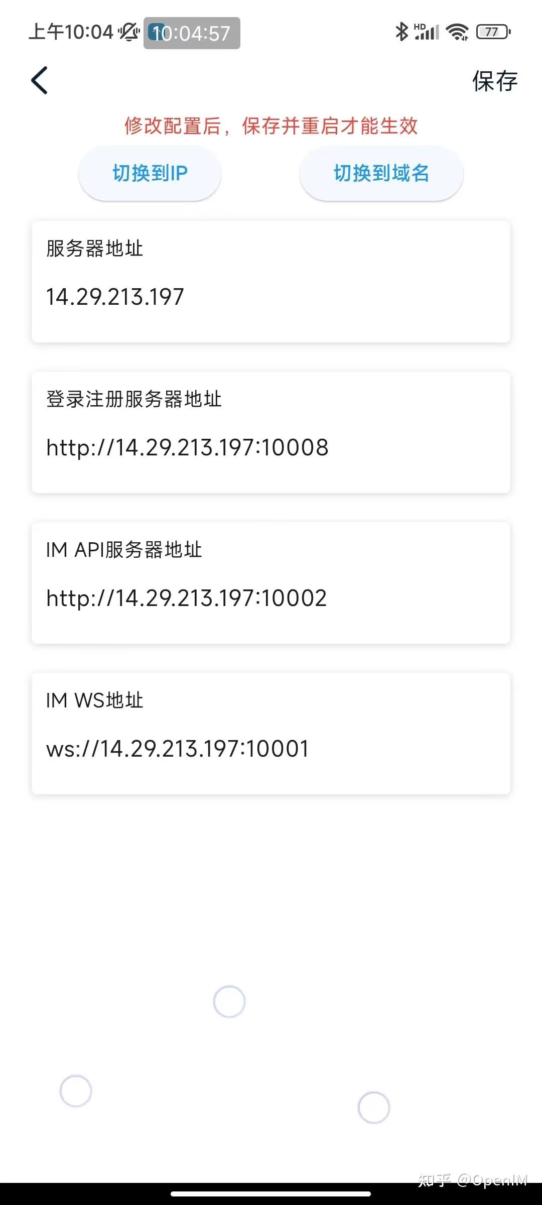

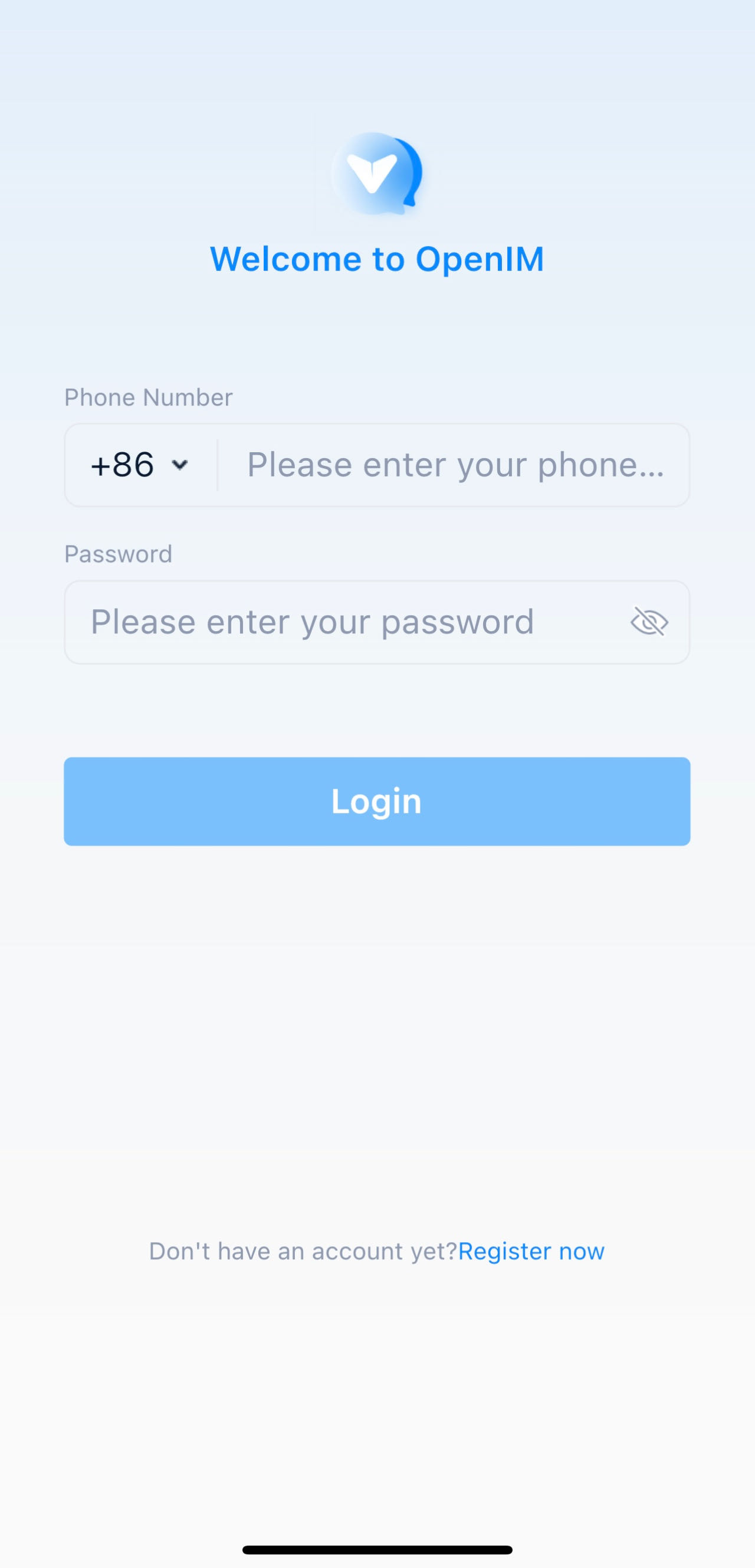

Note: Double-click on OpenIM and change the IP to the server’s OPENIM_IP then restart the App. Please ensure related ports are open, and restart the App after making changes. For first-time use, please register first through your mobile phone number, with the default verification code being 666666.
Image: Server Address Modification - Step 1
Image: Server Address Modification - Step 2
