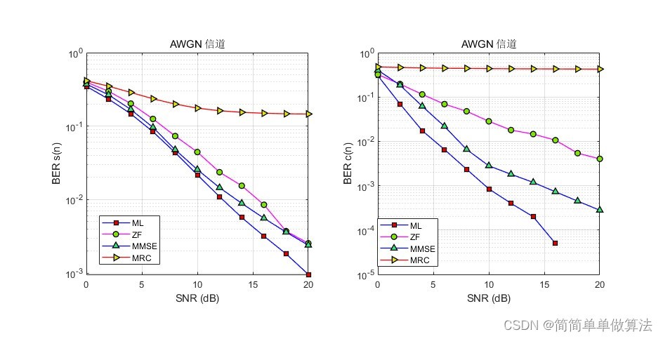

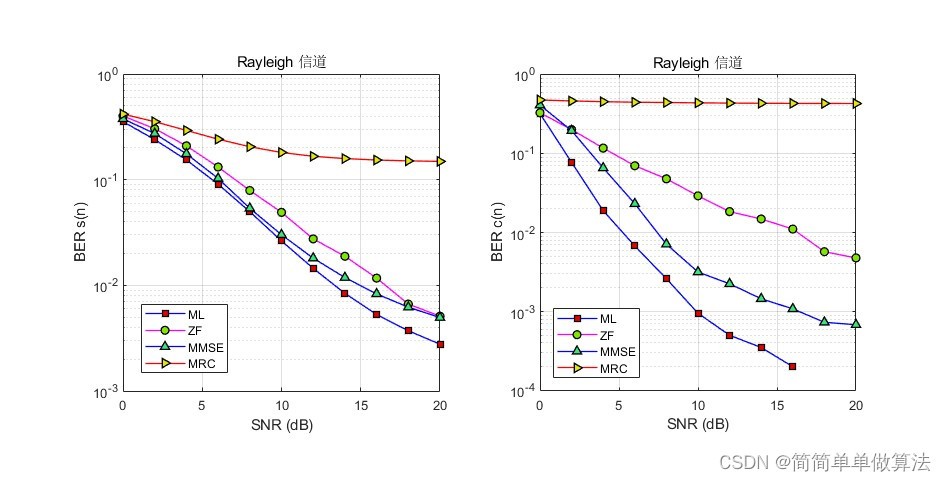

1.算法运行效果图预览

figure;
semilogy(SNR_dB,BER_s,'b-o')
hold on
semilogy(SNR_dB,BER_c,'r-s')
grid on
xlabel('SNR (dB)')
ylabel('BER')
legend('s(n)','c(n)')
save ML_Awgn.mat SNR_dB BER_s BER_c
