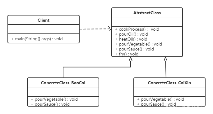

【例】炒菜
炒菜的步骤是固定的,分为倒油、热油、倒蔬菜、倒调料品、翻炒等步骤。现通过模板方法模式来用代码模拟。类图如下:
代码如下:

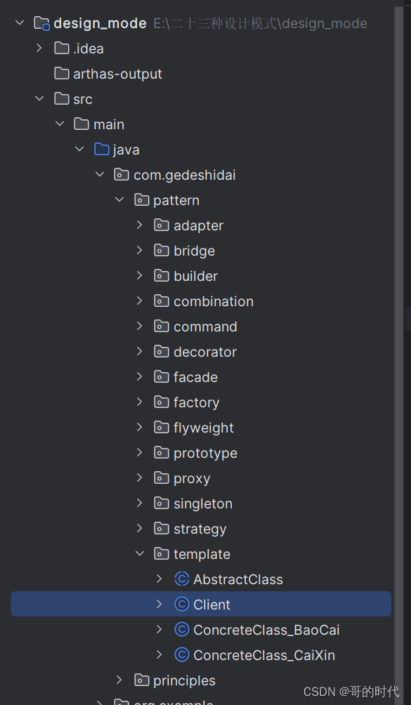

public class ConcreteClass_BaoCai extends AbstractClass {
    @Override
    public void pourVegetable() {
        System.out.println("下锅的蔬菜是包菜");
    @Override
    public void pourSauce() {
        System.out.println("下锅的酱料是辣椒");
public class ConcreteClass_CaiXin extends AbstractClass {
    @Override
        System.out.println("下锅的蔬菜是菜心");
    @Override
        System.out.println("下锅的酱料是蒜蓉");
public class Client {
        //炒手撕包菜
        //创建对象
        ConcreteClass_BaoCai baoCai = new ConcreteClass_BaoCai();
        //调用炒菜的功能
        baoCai.cookProcess();
        //炒蒜蓉菜心
        ConcreteClass_CaiXin caiXin = new ConcreteClass_CaiXin();
        caiXin.cookProcess();
