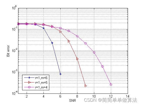

基于RM编译码的协作MIMO系统误码率matlab仿真,对比不同RM编译码参数
简简单单做算法 发表于 2023/12/25 15:11:07 2023/12/25
【摘要】 1.算法运行效果图预览  2.算法运行软件版本MATLAB2013b 3.算法理论概述       基于RM编译码的协作MIMO(多输入多输出)系统是一种利用多个天线和协作传输来提高通信系统性能的技术。        Reed-Muller(RM)码是一类经典的纠错编码,其编码和译码算法都拥有较低的复杂度,容易通过硬件电路实现。此外,RM码可以通过改变参数形成结构丰富的子类,能够适应不同信道...
1.算法运行效果图预览

4.部分核心程序
[V1,N1,K1,I1] = func_rm(r+1,m);
%R
[V2,N2,K2,I2] = func_rm(r,m);
for k = 1:length(SNR)
    k
    Err = 0;
    Num = 0;
    Len = 10000;
    TL  = 500;
    Rt  = K1/N1;%code rate
    N01 = 10^(-SNR(k)/Rt/10);
    Rt  = K2/N1;%code rate
    N02 = 10^(-SNR(k)/Rt/10);
    Rt  = (K1+K2)/(N1+N2);%code rate
    N03 = 10^(-SNR(k)/Rt/10);
    while(Err <= TL)
         k
         Err
         Num = Num + 1;
         %产生数据
         K             = min(K1,K2);
         Signal0       = randint(1,K,M,Len);
         Signal        = [Signal0,zeros(1,K1-K2)];
         %RM编码
         Signal_RM_S2D = func_Encode(Signal,V1);
         %调制
         RM_mod_S2D    = modulate(mods,Signal_RM_S2D);
         %过瑞利衰落信道,2条多径
         RM_Noise_S2D0 = RM_mod_S2D + sqrt(2*N01)*randn(size(RM_mod_S2D));
         RM_Noise_S2D1 = RM_mod_S2D + sqrt(2*N01)*randn(size(RM_mod_S2D));
         RM_Noise_S2D1 = [zeros(1,3),RM_Noise_S2D1(1:end-3)];
         RM_Noise_S2D2 = RM_mod_S2D + sqrt(2*N01)*randn(size(RM_mod_S2D));
         RM_Noise_S2D2 = [zeros(1,3),RM_Noise_S2D2(1:end-3)];
         RM_Noise_S2D  = RM_Noise_S2D0 + 0.2*RM_Noise_S2D1 + 0.1*RM_Noise_S2D2;
         %中继部分
         RM_demod_S2R  = demodulate(demods,RM_Noise_S2D);
         Bhat_S2R      = func_Decode(RM_demod_S2R,r+1,m,V1,N1,K1,I1);
         %RM编码
         Signal_RM_S2R = func_Encode(Bhat_S2R(1:K),V2);
         %调制
         RM_mod_S2R    = modulate(mods,Signal_RM_S2R);
         %过信道
         RM_Noise_S2R  = RM_mod_S2R + sqrt(2*N03)*randn(size(RM_mod_S2R));
         %解调
         RM_demod_S2D  = demodulate(demods,[RM_Noise_S2D,RM_Noise_S2R]);
         LEN           = length(RM_demod_S2D);
         %RM译码
         Bhat_S2D1     = func_Decode(RM_demod_S2D(1:LEN/2),r+1,m,V1,N1,K1,I1);
         Bhat_S2D2     = func_Decode(RM_demod_S2D(LEN/2+1:LEN),r,m,V2,N2,K2,I2);
         %计算误码率
         Err           = Err + min([sum(xor(Bhat_S2D1(1:K),Signal0)),sum(xor(Bhat_S2D2(1:K),Signal0))]);
    end
    Errs(k) = Err/Num/length(Signal);
end
figure
semilogy(SNR,Errs,'b-o');
grid on;
xlabel('SNR');
ylabel('Bit error');
if m == 4
   save r14.mat SNR Errs
end
if m == 5
   save r15.mat SNR Errs
end
if m == 6
   save r16.mat SNR Errs
end
