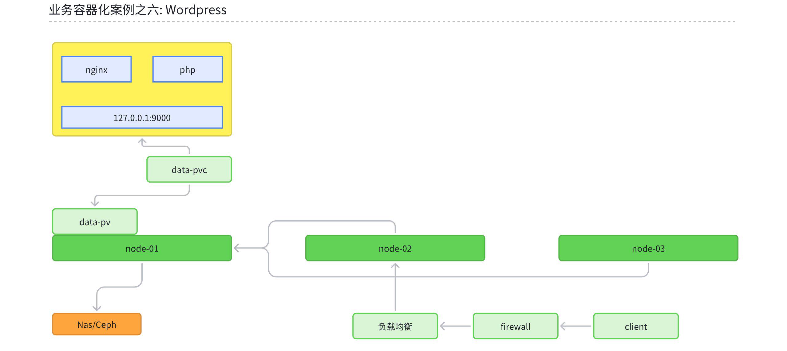

架构:

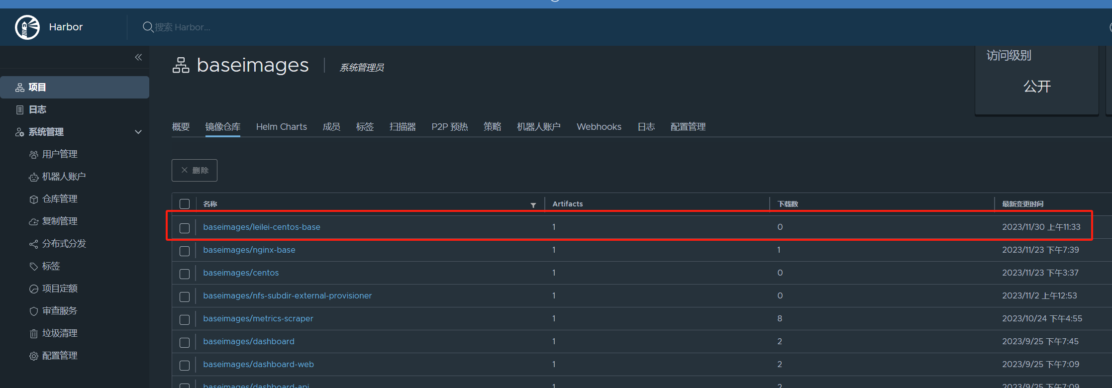

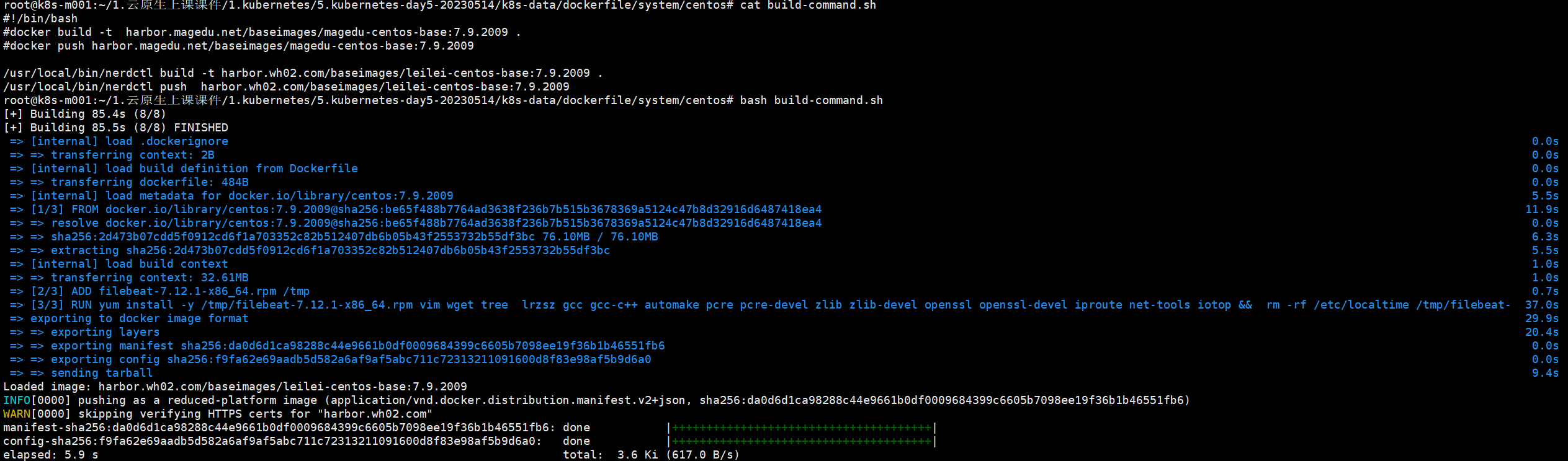

开始构建:
在harbor中查看:
得到centos基础镜像
harbor.wh02.com/baseimages/leilei-centos-base:7.9.2009
至此,centos基础镜像构建完成

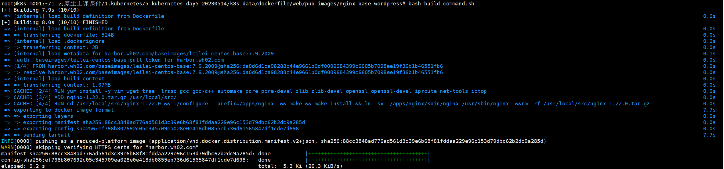

构建镜像:
bash build-command.sh
得到基础镜像地址:
harbor.wh02.com/pub-images/nginx-base-wordpress:v1.22.0

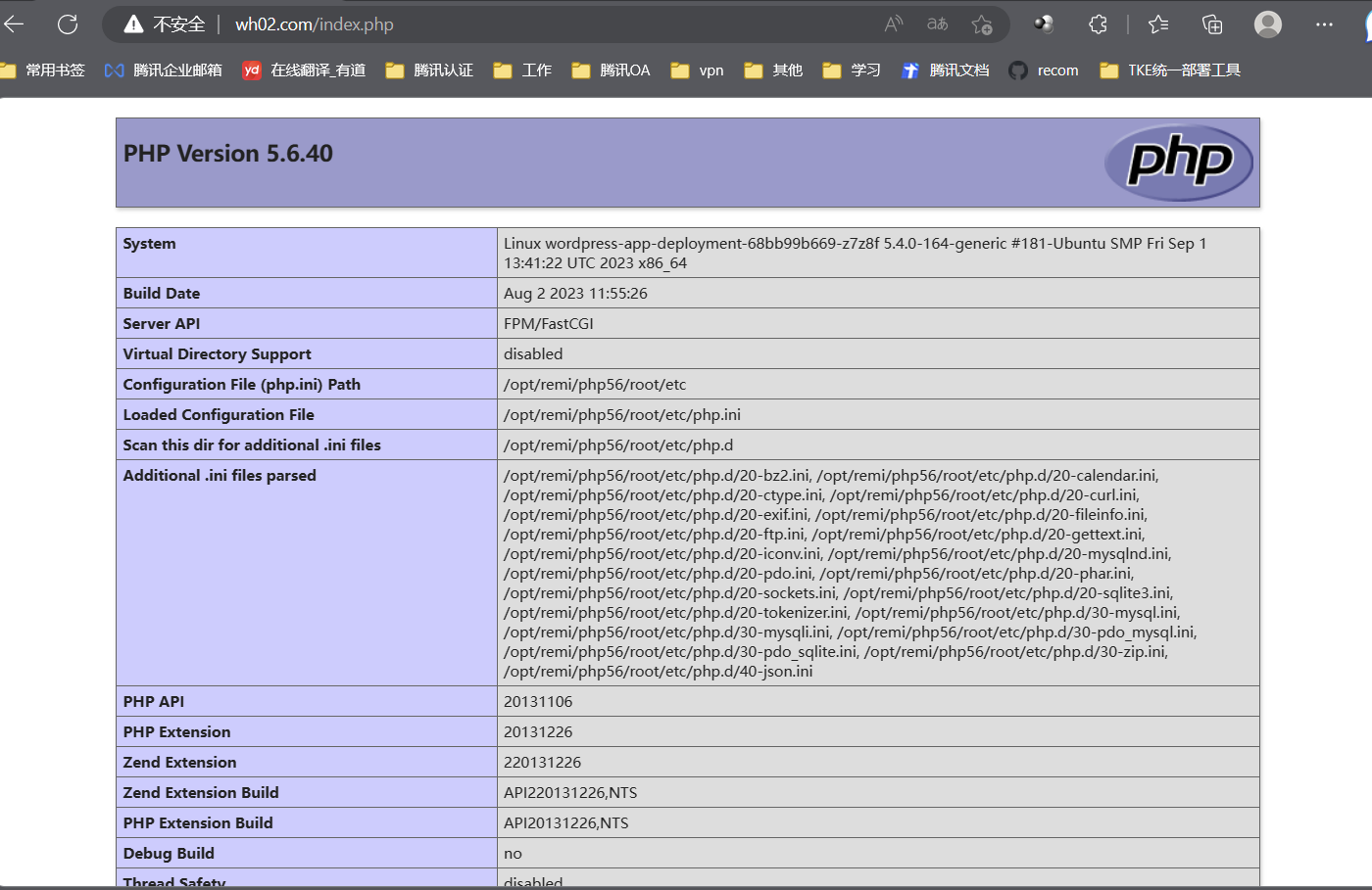

php可选 构建php5.6镜像
YAML
root@k8s-m001:~/1.云原生上课课件/1.kubernetes/5.kubernetes-day5-20230514/k8s-data/dockerfile/web/magedu/wordpress/php# ll
total 48
drwxr-xr-x 2 root root 4096 Dec 14 10:33 ./
drwxr-xr-x 4 root root 4096 Aug 9 2022 ../
-rwxr-xr-x 1 root root 316 Dec 13 18:07 build-command.sh*
-rw-r--r-- 1 root root 428 Dec 14 10:28 Dockerfile
-rwxr-xr-x 1 root root 184 Dec 14 10:26 run_php.sh*
-rw-r--r-- 1 root root 19220 Jun 22 2021 www.conf
cat build-command.sh:
#!/bin/bash
TAG=$1
#docker build -t harbor.linuxarchitect.io/magedu/wordpress-php-5.6:${TAG} .
nerdctl build -t harbor.wh02.com/magedu/wordpress-php-5.6:${TAG} .
echo "镜像制作完成,即将上传至Harbor服务器"
sleep 1
nerdctl push harbor.wh02.com/magedu/wordpress-php-5.6:${TAG}
echo "镜像上传完成"
cat Dockerfile:
#PHP Base Image
FROM harbor.wh02.com/baseimages/leilei-centos-base:7.9.2009
MAINTAINER zhangshijie@magedu.net
RUN yum install -y https://mirrors.tuna.tsinghua.edu.cn/remi/enterprise/remi-release-7.rpm && yum install php56-php-fpm php56-php-mysql -y
ADD www.conf /opt/remi/php56/root/etc/php-fpm.d/www.conf
#RUN useradd nginx -u 2019
ADD run_php.sh /usr/local/bin/run_php.sh
EXPOSE 9000
CMD ["/usr/local/bin/run_php.sh"]
cat run_php.sh:
#!/bin/bash
#echo "nameserver 10.20.254.254" > /etc/resolv.conf
/opt/remi/php56/root/usr/sbin/php-fpm
#/opt/remi/php56/root/usr/sbin/php-fpm --nodaemonize
tail -f /etc/hosts
cat www.conf
[www]
user = nginx
group = nginx
listen = 0.0.0.0:9000
pm = dynamic
pm.max_children = 50
pm.start_servers = 5
pm.min_spare_servers = 5
pm.max_spare_servers = 35
slowlog = /opt/remi/php56/root/var/log/php-fpm/www-slow.log
php_admin_value[error_log] = /opt/remi/php56/root/var/log/php-fpm/www-error.log
php_admin_flag[log_errors] = on
php_value[session.save_handler] = files
php_value[session.save_path] = /opt/remi/php56/root/var/lib/php/session
php_value[soap.wsdl_cache_dir] = /opt/remi/php56/root/var/lib/php/wsdlcache
执行构建:
bash build-command.sh v1
得到php镜像地址:
harbor.wh02.com/magedu/wordpress-php-5.6:v1

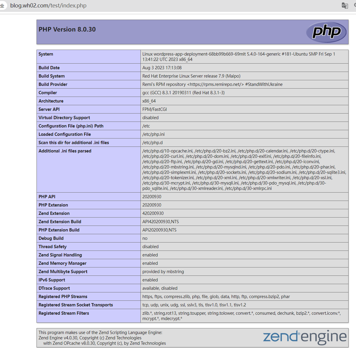

php可选 构建php8镜像
使用的基础centos镜像,部署为php8版本的镜像
YAML

构建镜像:
Dockerfile
得到php8镜像:
harbor.wh02.com/magedu/wordpress-php-8.0:v1

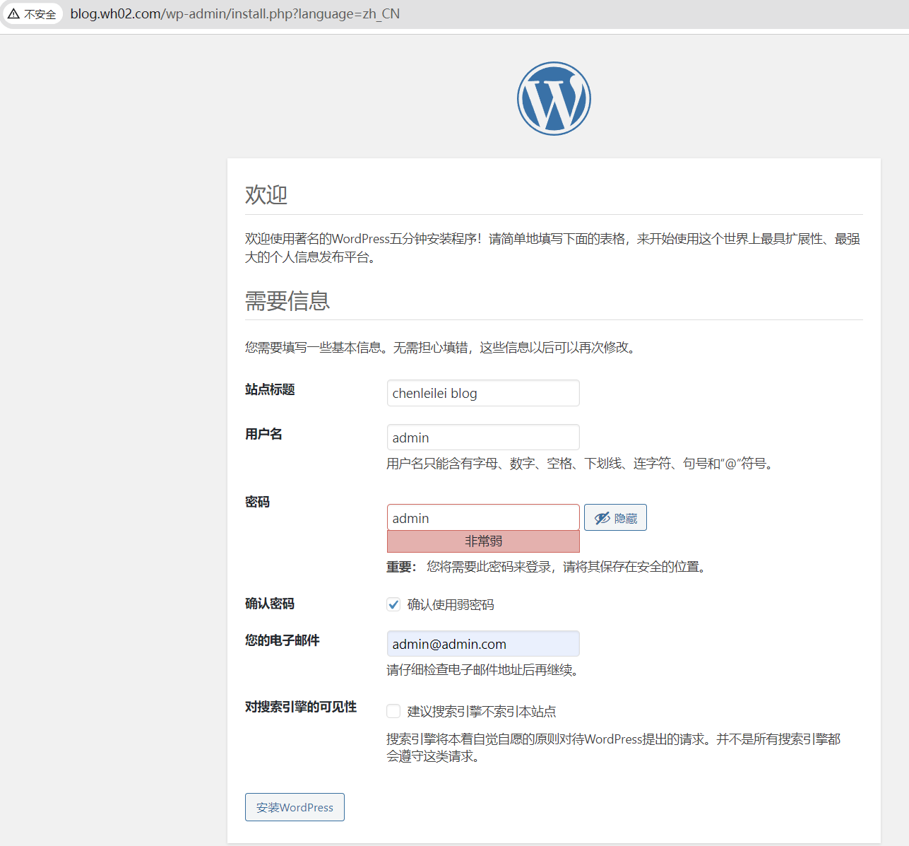

构建wordpress业务镜像
YAML
root@k8s-m001:~wordpress/nginx# ll
total 28
drwxr-xr-x 2 root root 4096 Dec 13 18:13 ./
-rwxr-xr-x 1 root root 302 Dec 13 16:43 build-command.sh*
-rw-r--r-- 1 root root 358 Dec 13 16:39 Dockerfile
-rw-r--r-- 1 root root 11 Jun 22 2021 index.html
-rw-r--r-- 1 root root 3367 Dec 13 16:40 nginx.conf
-rwxr-xr-x 1 root root 151 Jun 22 2021 run_nginx.sh*
Dockerfile (引用基础镜像 harbor.wh02.com/magedu/wordpress-nginx:v1 )
YAML
FROM harbor.wh02.com/pub-images/nginx-base-wordpress:v1.22.0
ADD nginx.conf /apps/nginx/conf/nginx.conf
ADD run_nginx.sh /apps/nginx/sbin/run_nginx.sh
RUN mkdir -pv /home/nginx/wordpress
RUN chown nginx.nginx /home/nginx/wordpress/ -R
EXPOSE 80 443
CMD ["/apps/nginx/sbin/run_nginx.sh"]
index.html
YAML
cat index.html:
nginx web1
nginx.conf
YAML
user nginx nginx;
worker_processes auto;

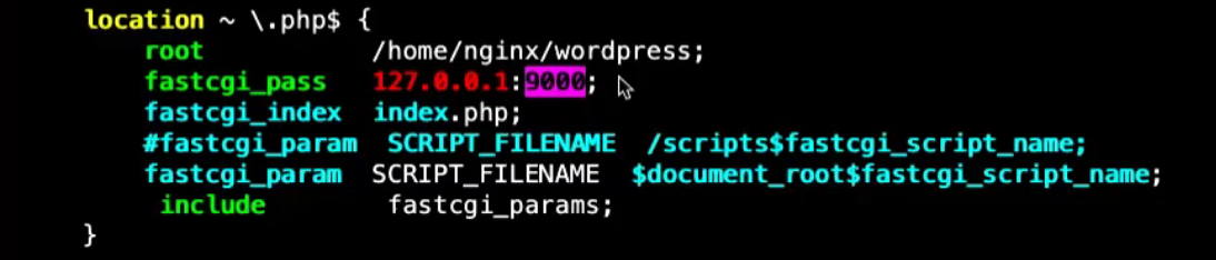

location ~ \.php$ {
root /home/nginx/wordpress;
fastcgi_pass 127.0.0.1:9000;
fastcgi_index index.php;
#fastcgi_param SCRIPT_FILENAME /scripts$fastcgi_script_name;
fastcgi_param SCRIPT_FILENAME $document_root$fastcgi_script_name;
include fastcgi_params;

执行构建:
YAML
得到镜像地址:
得到基础镜像地址:
harbor.wh02.com/magedu/wordpress-php-8.0:v1 [可选]

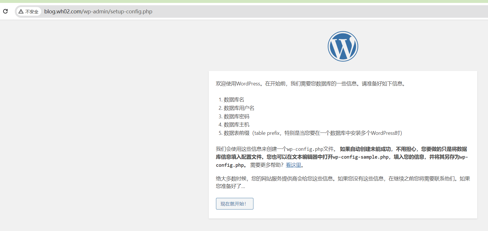

访问域名:
http://wh02.com/
域名可以改为
http://blog.wh02.com
用于安装wordpress

在线安装wordpress:
这里为了方便。添加了blog.wh02.com域名
注意这里还有个问题,为了有完整权限,还需要将nfs中目录权限修改为nginx的用户ID

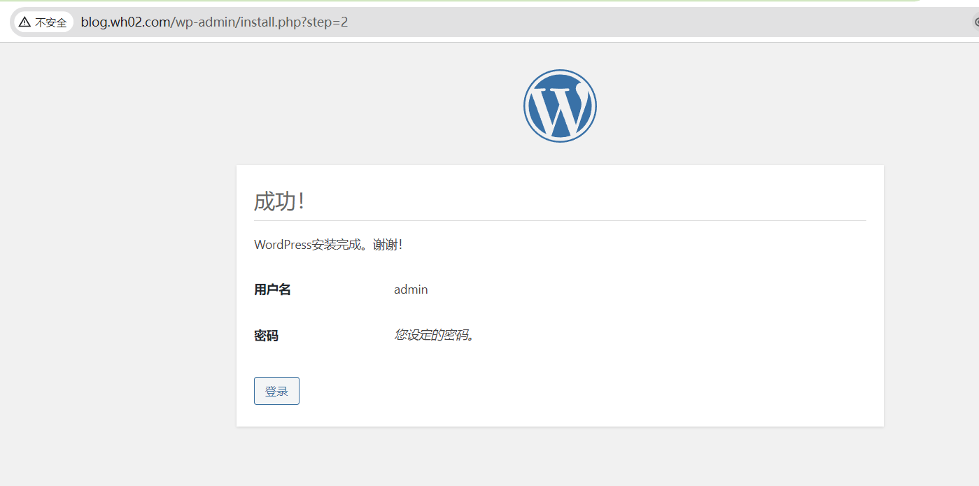

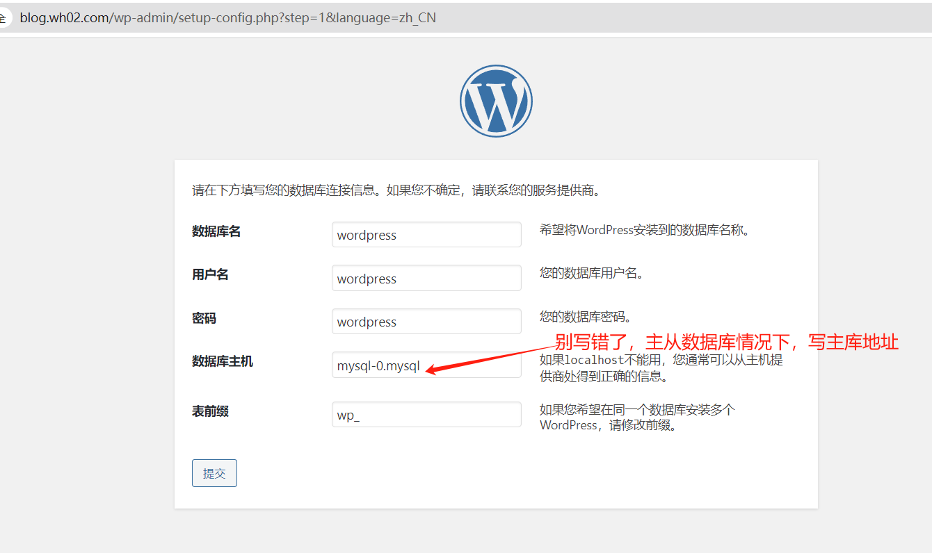

web安装页面添加配置好的数据库信息
提交后的页面:

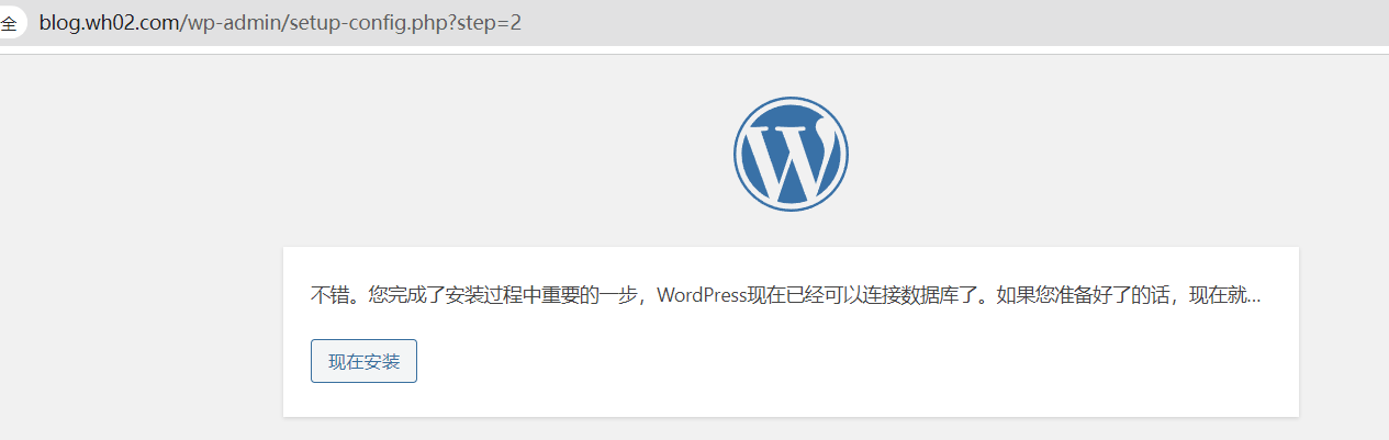

点现在安装
注意,如果是多个pod部署,在nginx中的配置里需要写php这个pod的svc地址

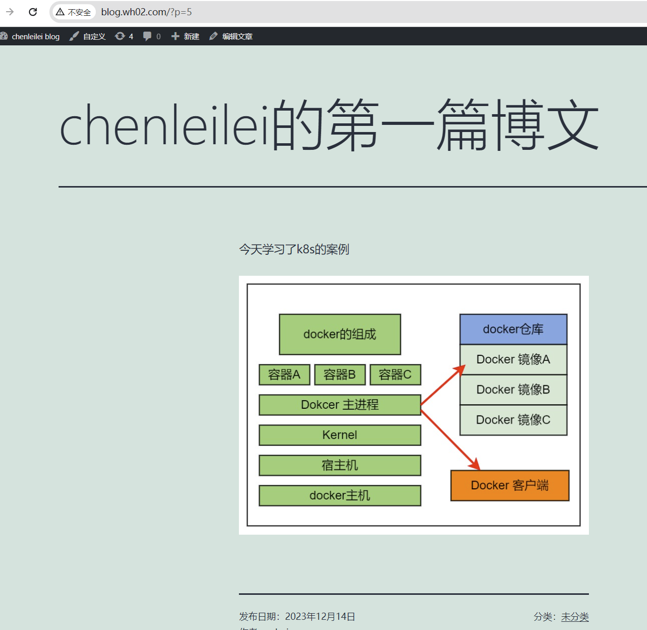

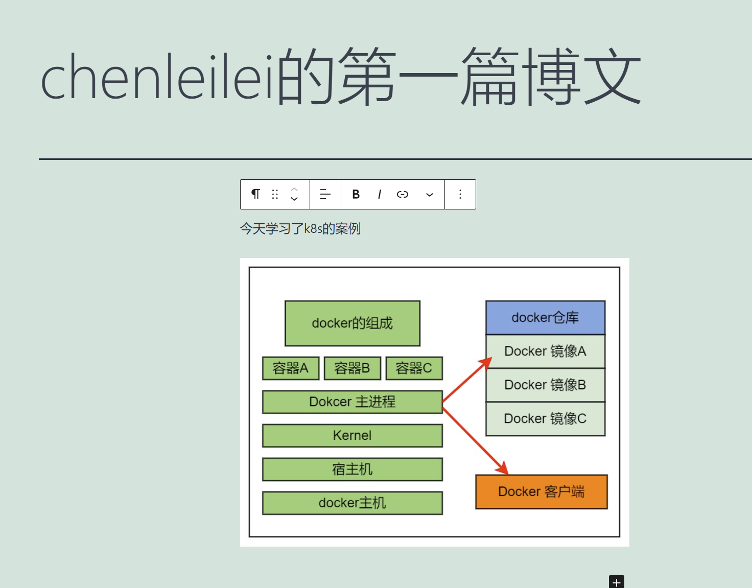

测试写博文插入图片
查看文章:
