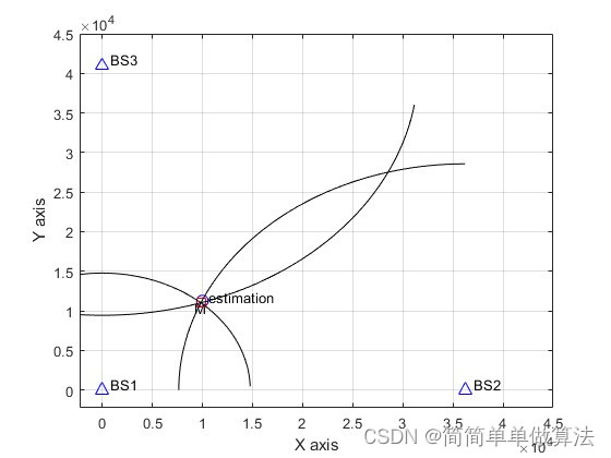

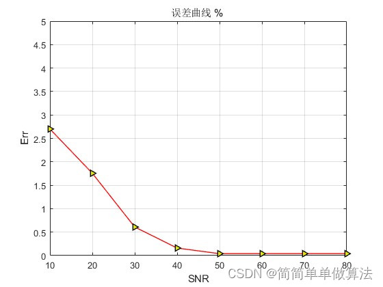

1.算法运行效果图预览

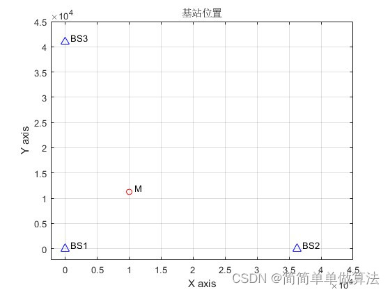

figure;
plot(P1x,P1y,'b^','Markersize',8);
hold on;
plot(P2x,P2y,'b^','Markersize',8);
hold on;
plot(P3x,P3y,'b^','Markersize',8);
hold on;
text(P1x+800,P1y+800,'BS1');
text(P2x+800,P2y+800,'BS2');
text(P3x+800,P3y+800,'BS3');
xlabel('X axis');
ylabel('Y axis');
axis([-3*LL/20,3*LL,-3*LL/20,3*LL]);
grid on;
%这里随机生成移动物体的位置坐标
P0x = 2*LL/3;
P0y = 3*LL/4;
plot(P0x,P0y,'ro','Markersize',6);hold off;
text(P0x+800,P0y+800,'M');
title('基站位置');

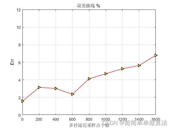

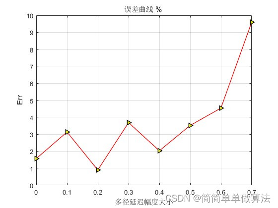

    %加入多径
    for jj = 1:N
        signals  = r2(jj,:);
        if Mpd == 0
           signals2 = signals;
        else
           signals2 = signals + 0.65*[zeros(1,Mpd),signals(1:end-Mpd)];
        end
        r3(jj,:) = signals2;
    end

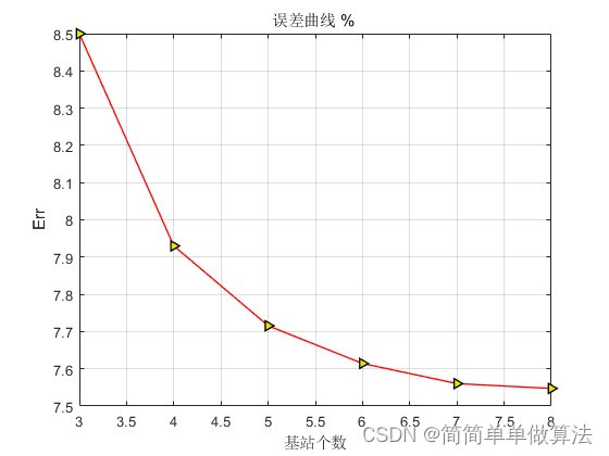

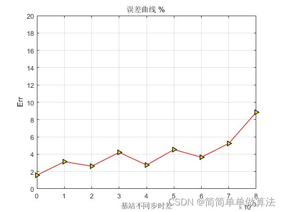

figure;
plot(SNR,Err,'-r>',...
    'LineWidth',1,...
    'MarkerSize',6,...
    'MarkerEdgeColor','k',...
    'MarkerFaceColor',[0.9,0.9,0.0]);
grid on;
title('误差曲线 % ');
xlabel('SNR');
ylabel('Err');
axis([10,80,0,5]);

figure;
plot(P1x,P1y,'b^','Markersize',8);hold on;
plot(P2x,P2y,'b^','Markersize',8);hold on;
plot(P3x,P3y,'b^','Markersize',8);hold on;
grid on;
xlabel('X axis');
ylabel('Y axis');
plot(P0x,P0y,'bo','Markersize',8);
hold on;
text(P0x-800,P0y-800,'M');
SEL = 1;
plot(X_theory(SEL),Y_theory(SEL),'rs','Markersize',8);hold on;
text(X_theory(SEL)+800,Y_theory(SEL)+800,'estimation');
R1 = sqrt((X_theory(SEL)-P1x)^2+(Y_theory(SEL)-P1y)^2);
R2 = sqrt((X_theory(SEL)-P2x)^2+(Y_theory(SEL)-P2y)^2);
R3 = sqrt((X_theory(SEL)-P3x)^2+(Y_theory(SEL)-P3y)^2);
alpha=0.01*pi:pi/100:0.55*pi;
x1= P1x+R1*cos(alpha);
y1= P1y+R1*sin(alpha);
hold on;
plot(x1,y1,'k-');
alpha=0.5*pi:pi/100:1.0*pi;
x2= P2x+R2*cos(alpha);
y2= P2y+R2*sin(alpha);
hold on;
plot(x2,y2,'k-');
alpha=1.1*pi:pi/100:1.95*pi;
x3= P3x+R3*cos(alpha);
y3= P3y+R3*sin(alpha);
hold on;
plot(x3,y3,'k-');
