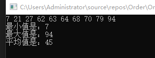

练习题:
生成10个随机数 进行 升序排序 算出 最大值 最小值 平均值
答案:
 Random r = new Random();
            int[] arr = new int[10];
            int average = 0;
            for (int i = 0; i < arr.Length; i++)
                arr[i] = r.Next(-10,100);
           average += arr[i];
            for (int j = 0; j < arr.Length - 1; j++)
                if (arr[i] < arr[j])
                    int tmp = arr[i];
                    arr[i] = arr[j];
                    arr[j] = tmp;
        foreach (int number in arr)
            Console.Write(number + " ");
        Console.WriteLine("\n最小值是:" + arr[0]);
         Console.WriteLine("最大值是:" + arr[arr.Length-1]);
        Console.WriteLine("平均值是:" + (average / arr.Length - 1));
            Console.ReadKey();
