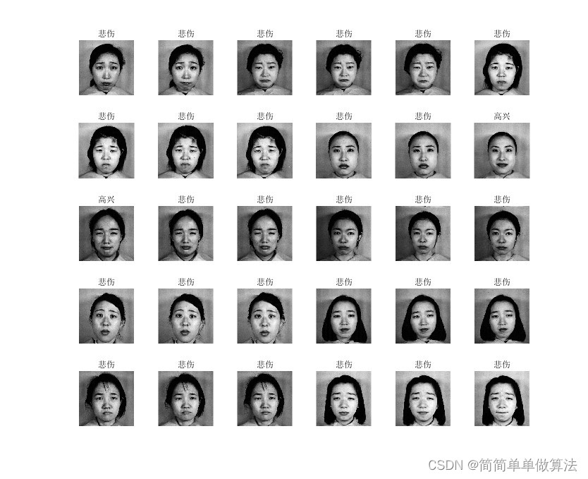

4.部分核心程序

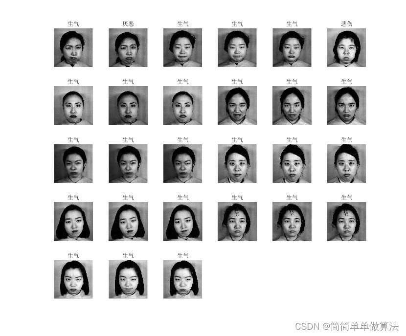

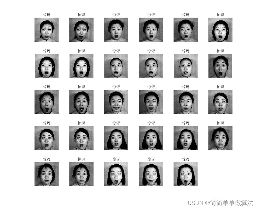

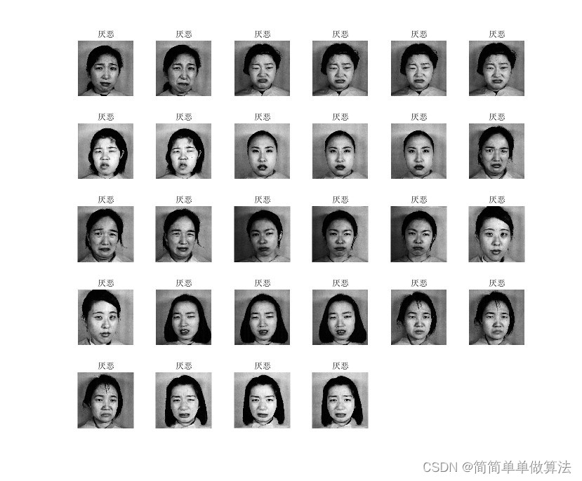

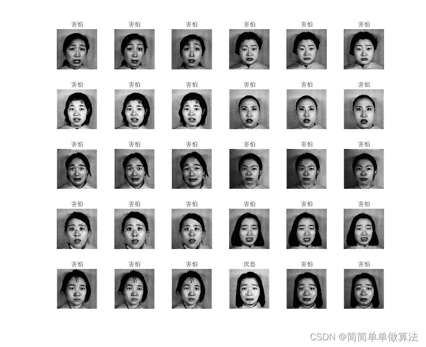

NAME = '悲伤';%测试则对所有图片进行测试
p0 = ['JAFFE\',NAME];
dt = dir(p0);
p  = [dt.name];
err=[];
correct1 = 0;
figure;
for k = 1:length(dt)-3
    k
    path = dt(k+3,1).name;
    I0      = imread([ 'JAFFE\',NAME,'\',path]);
    [R,C,K] = size(I0);
    if K == 1
       I1 = I0;
    else
       I1 = rgb2gray(I0);
    end
    %特征提取
    Hog_Dat1 = func_feature(I1);
    FF2 = sim(net,Hog_Dat1);
    subplot(5,6,k);
    imshow(I0);
    if round(FF2) == 1
       title('悲伤');
       correct1 = correct1+1;
    end
    if round(FF2) == 2
       title('高兴');
    end
    if round(FF2) == 3
       title('害怕');
    end
    if round(FF2) == 4
       title('惊讶');
    end
    if round(FF2) == 5
       title('生气');
    end
    if round(FF2) == 6
       title('厌恶');
    end
    if round(FF2) == 7
       title('中立');
    end
    pause(0.2);
end
err=[err,correct1/(length(dt)-3)];

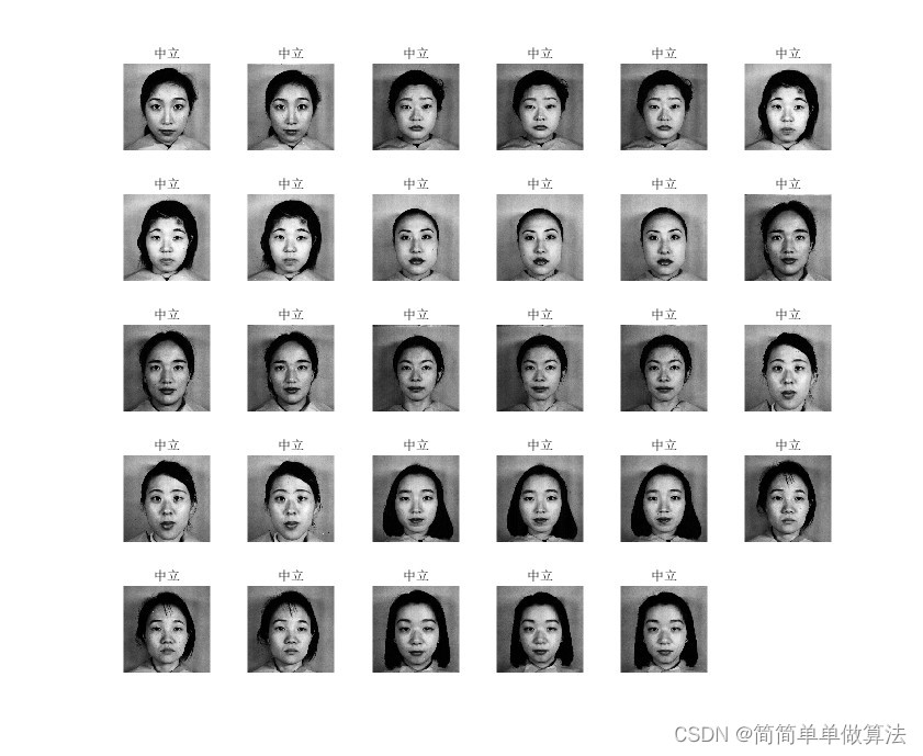

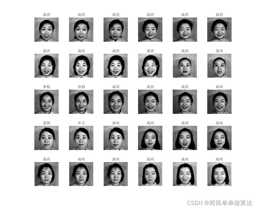

NAME = '中立';%测试则对所有图片进行测试
dt = dir(p0);
p  = [dt.name];
correct1 = 0;
figure;
    k
    [R,C,K] = size(I0);
    if K == 1
       I1 = I0;
    else
       I1 = rgb2gray(I0);
    end
    %特征提取
    subplot(5,6,k);
    imshow(I0);
    if round(FF2) == 1
       title('悲伤');
    end
    if round(FF2) == 2
       title('高兴');
    end
    if round(FF2) == 3
       title('害怕');
    end
    if round(FF2) == 4
       title('惊讶');
    end
    if round(FF2) == 5
       title('生气');
    end
    if round(FF2) == 6
       title('厌恶');
    end
    if round(FF2) == 7
       title('中立');
    end
    pause(0.2);
end

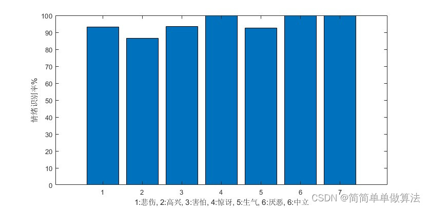

figure;
bar(100*err)
xlabel('1:悲伤, 2:高兴, 3:害怕, 4:惊讶, 5:生气, 6:厌恶, 6:中立');
ylabel('情绪识别率%');
