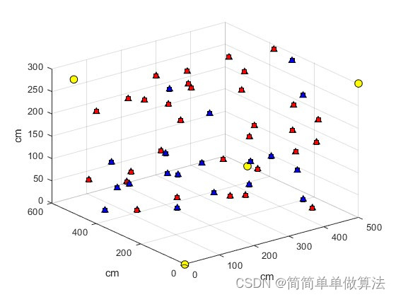

1.算法运行效果图预览

4.部分核心程序
kkk = 0;
for EbN0 = EbN0_sub
    kkk
    kkk = kkk + 1;
    for jj1 = 1:Tag_Num
        jj1
        rng(jj1);
        for jj = 1:num_bits
            %TAG to BS1
            delay_1         = round(time_bs_tag(1,jj1)/ts);
            xx1             = zeros(1,delay_1);
            %传播时延
            delay_1_1(jj,:) = [xx1 sig(1:end-length(xx1))];
            %UWB
            h_4             = uwb_channel(dist_bs_tag(1,jj1));
            %信号经过信道
            conv_data1      = conv(delay_1_1(jj,:),h_4);
            UWB_chan1(jj,:) = conv_data1(1:length(sig));
            %TAG to BS2
            delay_2         = round(time_bs_tag(2,jj1)/ts);
            xx2             = zeros(1,delay_2);
            %传播时延
            delay_2_1(jj,:) = [xx2 sig(1:end-length(xx2))];
            h_2             = uwb_channel(dist_bs_tag(2,jj1));
            conv_data2      = conv(delay_2_1(jj,:),h_2);
            UWB_chan2(jj,:) = conv_data2(1:length(sig));
            %TAG to BS3
            delay_3         = round(time_bs_tag(3,jj1)/ts);
            xx3             = zeros(1,delay_3);
            %传播时延
            delay_3_1(jj,:) = [xx3 sig(1:end-length(xx3))];
            h_3             = uwb_channel(dist_bs_tag(3,jj1));
            conv_data3      = conv(delay_3_1(jj,:),h_3);
            UWB_chan3(jj,:) = conv_data3(1:length(sig));
            %TAG to BS4
            delay_4         = round(time_bs_tag(4,jj1)/ts);
            xx4             = zeros(1,delay_4);
            %传播时延
            delay_4_1(jj,:) = [xx4 sig(1:end-length(xx4))];
            h_4             = uwb_channel(dist_bs_tag(4,jj1));
            conv_data4      = conv(delay_4_1(jj,:), h_4);
            UWB_chan4(jj,:) = conv_data4(1:length(sig));
        end
        for jj = 1:num_bits
            UWB_chan1n(jj,:) = awgn(UWB_chan1(jj,:)/max(UWB_chan1(jj,:)),EbN0,'measured');
            UWB_chan2n(jj,:) = awgn(UWB_chan2(jj,:)/max(UWB_chan2(jj,:)),EbN0,'measured');
            UWB_chan3n(jj,:) = awgn(UWB_chan3(jj,:)/max(UWB_chan3(jj,:)),EbN0,'measured');
            UWB_chan4n(jj,:) = awgn(UWB_chan4(jj,:)/max(UWB_chan4(jj,:)),EbN0,'measured');
        end
        %自适应前沿检测
        %自适应前沿检测
    end
end
P_est0 = [x_est0',y_est0',z_est0'];
P_est1 = [x_est1',y_est1',z_est1'];

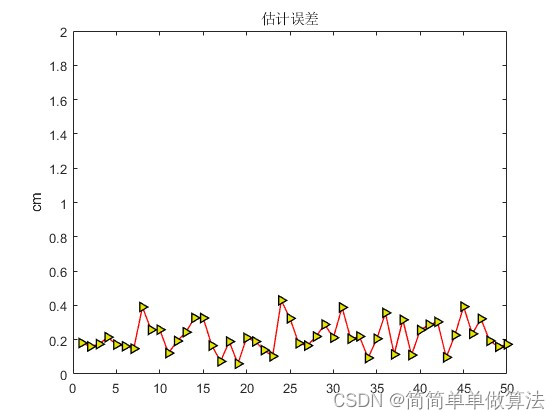

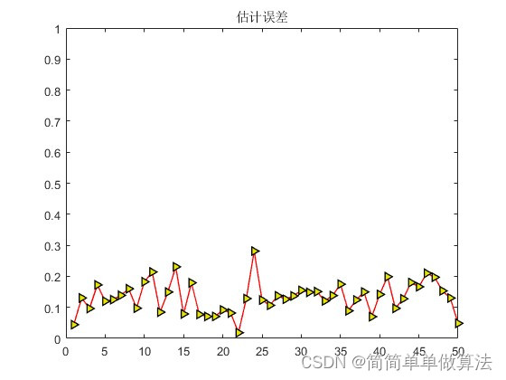

figure;
plot(toa_error0,'-r>',...
    'LineWidth',1,...
    'MarkerSize',6,...
    'MarkerEdgeColor','k',...
    'MarkerFaceColor',[0.9,0.9,0.0]);
hold on
title('估计误差')
axis([0,Tag_Num,0,2]);
ylabel('cm');

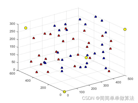

figure
axis([0 10 0 10 0 10]);
for i=1:BS_Num
    plot3(BS_pos(i,1),BS_pos(i,2),BS_pos(i,3),'ko','MarkerFace','y','MarkerSize',8);
    hold on
end
hold on
for i=1:Tag_Num
plot3(Tag(i,1),Tag(i,2),Tag(i,3),'k^','MarkerFace','b','MarkerSize',6);
hold on
plot3(x_est1(i),y_est1(i),z_est1(i),'ks','MarkerFace','r','MarkerSize',6);
hold on
end
grid on
xlabel('cm');
ylabel('cm');
zlabel('cm');
save R.mat toa_error1
