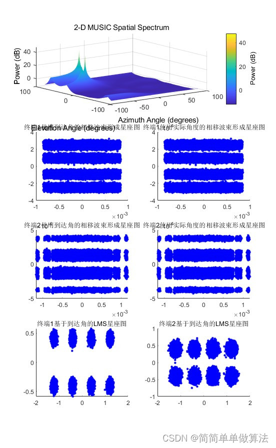

1.算法运行效果图预览

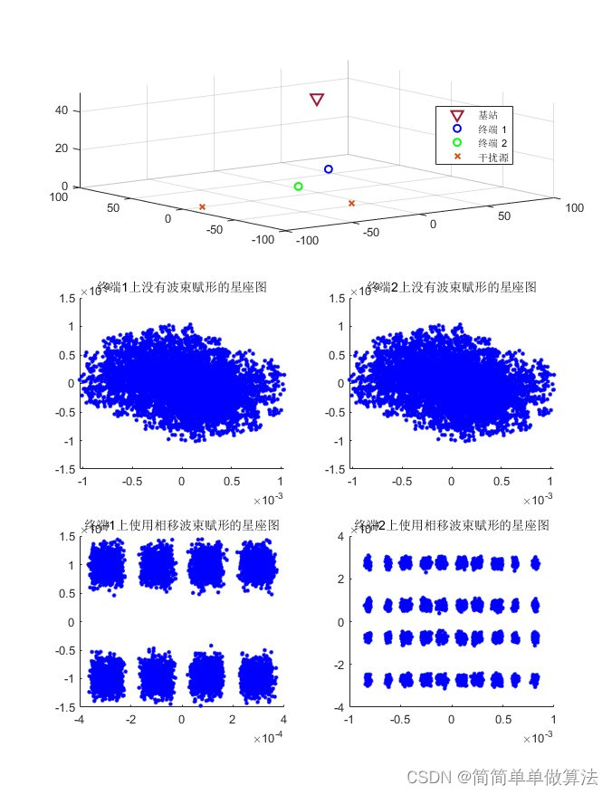

    %信道生成
    receivedW = collectPlaneWave(GM.BSarray, [y_1*(1/sqrt(path_loss_t1)) y_2*(1/sqrt(path_loss_t2)) y_3*(1/sqrt(path_loss_i1)) y_3*(1/sqrt(path_loss_i2))], [t1Angles' t2Angles' i1Angles' i2Angles'], Pars.fc);
    %添加噪声
    chOut = awgn(receivedW, snr, 'measured');
     %在终端1上没有波束赋形的情况下计算BER

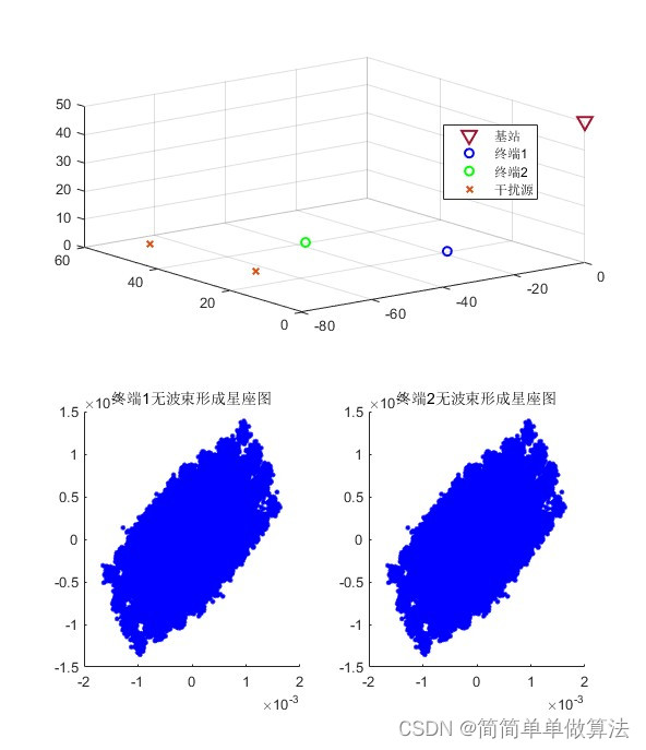

     subplot(3,2,3);
     title='终端1上没有波束赋形的星座图';
     bits=func_OFDM_demod(y_ofdm,chOut(:,end),NOrder,true,title);
     [numbError,ratio]=biterr(x_1,bits);
     %在终端2上没有波束赋形的情况下计算BER
     subplot(3,2,4);
     title='终端2上没有波束赋形的星座图';
     [numbError,ratio]=biterr(x_2,bits);
     %相移波束赋形
    % 终端1通过PhaseShiftBeamformer进行波束赋形
    beamformerV1 = phased.PhaseShiftBeamformer('SensorArray',GM.BSarray,'OperatingFrequency',Pars.fc,'PropagationSpeed',Pars.c,'Direction',t1Angles','WeightsOutputPort',true);
    [y1,w1]      = beamformerV1(chOut);
     %在终端1上使用相移波束赋形的情况下计算BER
    subplot(3,2,5);
    title='终端1上使用相移波束赋形的星座图';
    bits=func_OFDM_demod(y_ofdm,y1,NOrder,true,title);
    % 终端2通过PhaseShiftBeamformer进行波束赋形
    beamformerV2 = phased.PhaseShiftBeamformer('SensorArray',GM.BSarray,'OperatingFrequency',Pars.fc,'PropagationSpeed',Pars.c,'Direction',t2Angles','WeightsOutputPort',true);
    [y2,w2] = beamformerV2(chOut);
     %使用LMS算法进行波束赋形
    subplot(3,2,6);
    title='终端2上使用相移波束赋形的星座图';
    bits=func_OFDM_demod(y_ofdm,y2,NOrder,true,title);

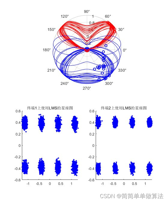

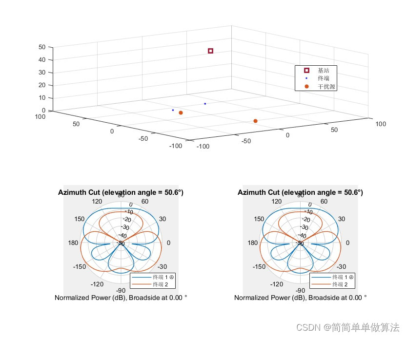

    figure(2);
    subplot(2,2,[1,2]);
    polarplot( deg2rad(az_t1),t1_dist_BS/max(t1_dist_BS,t2_dist_BS), 'or','LineWidth',1.5)
    hold on
    polarplot( deg2rad(az_t2),t2_dist_BS/max(t1_dist_BS,t2_dist_BS),'ob','LineWidth',1.5)
    hold on
    H=pattern(GM.BSarray,Pars.fc,[-180:180],el_t1,'PropagationSpeed',Pars.c,'Type','power','CoordinateSystem','polar','Weights',conj(w1));
    hold on
    polarplot(H,'r')
    H=pattern(GM.BSarray,Pars.fc,[-180:180],el_t2,'PropagationSpeed',Pars.c,'Type','power','CoordinateSystem','polar','Weights',conj(w2));
    hold on
    polarplot(H,'b')
    %计算LMS权重
    optimalWeight1 = func_LMS(chOut,y_1,numArray);
    optimalWeight2 = func_LMS(chOut,y_2,numArray);
    %将接收信号与权重相乘
    y1=chOut*((optimalWeight1));
    y2=chOut*((optimalWeight2));
    %在终端1上使用LMS波束赋形的情况下计算BER
    subplot(2,2,3);
    title='终端1上使用LMS的星座图';
     bits=func_OFDM_demod(y_ofdm,(y1),NOrder,true,title);
    %在终端2上使用LMS波束赋形的情况下计算BER
    subplot(2,2,4);
    title='终端2上使用LMS的星座图';
    bits=func_OFDM_demod(y_ofdm,(y2),NOrder,true,title);
