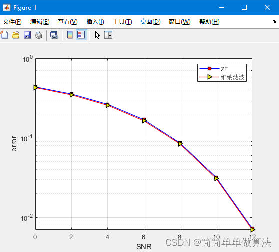

3.算法运行效果图预览

 % 产生复杂高斯噪声 V 矩阵并加入 ISI 信道
    noise      = (randn(N*LEN,1)+1i*randn(N*LEN,1));
    %ISI Channel Generation
    t_matrix   = conv(x,Cmat);
    Y          = t_matrix(1:N*LEN)+noise;
    % 应用零消除滤波
    Y_conv     = conv(Y,Wn_ZF);
    % 最小 A
    QPSK_Set   = [complex(A,A), complex(A,-A), complex(-A,A),complex(-A,-A)];
    for k = 1:N*LEN
        for q = 1:4
            Y_diff        = Y_conv(k) - QPSK_Set(q);
            norm_diff     = norm(Y_diff,2);
            norm_diff2(q) = norm_diff;
        end
        [minvalue , minindx] = min(norm_diff2);
        value(k) = minvalue;
        indx(k)  = minindx;
    end
