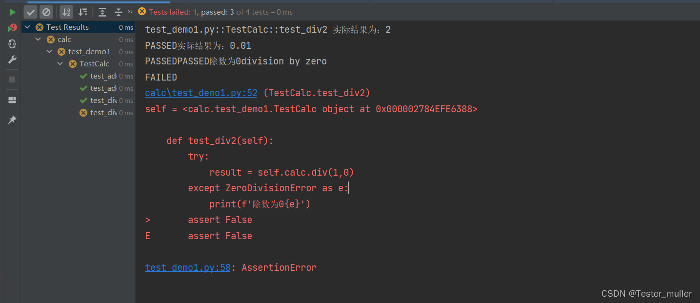

使用示例
pytest.ini文件如下:
[pytest]
addopts = -vs
被测程序如下:
class Calculator:
    def add(self, a, b):
        if a > 99 or a < -99 or b > 99 or b < -99:
            print("请输入范围为【-99, 99】的整数或浮点数")
            return "参数大小超出范围"
        return a + b
    def div(self, a, b):
            return "参数大小超出范围"
        return a / b
测试脚本如下:
class TestCalc:
    def setup(self):
        self.calc=Calculator()
    def test_add1(self):
        result = self.calc.add(1, 1)
        print(f"实际结果为:{result}")
        expect = 2
        assert result == expect
    def test_add2(self):
        result = self.calc.add(-0.01, 0.02)
        # 期望结果
        expect = 0.01
        # 断言
    def test_div1(self):
        result = self.calc.div(1,1)
        assert result == 1
    def test_div2(self):
        try:
            result = self.calc.div(1,0)
        except ZeroDivisionError as e:
            print(f'除数为0{e}')
        assert False
输出结果如下图:
