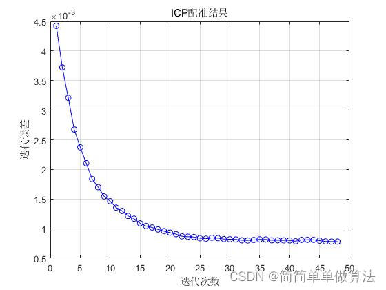

ALL_Normal = [Normal1_new;Normal2_new];%拼接后的点云法向量
%绘制迭代误差图和点云配准结果图
figure;
plot(Derr,'b-o');
xlabel('迭代次数');
ylabel('迭代误差');
grid on
title('ICP配准结果');

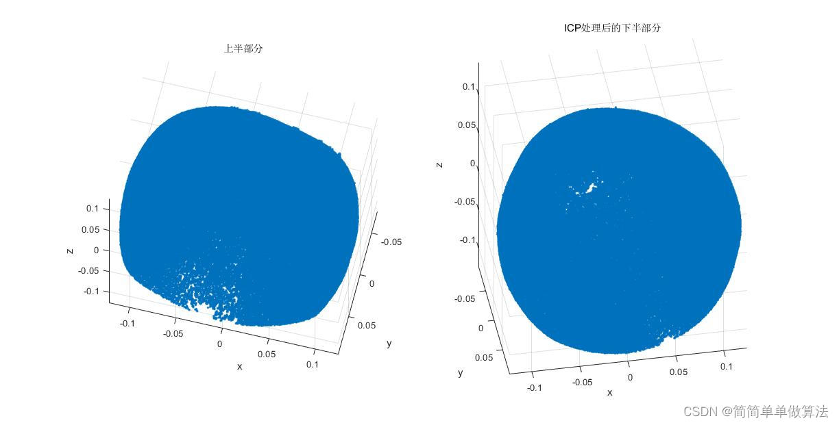

figure;
subplot(121);
plot3(target_(:,1),target_(:,2),target_(:,3),'.');
grid on
axis equal
xlabel('x');
ylabel('y');
zlabel('z');
title('上半部分');
subplot(122);
plot3(Reallignedsource(:,1),Reallignedsource(:,2),Reallignedsource(:,3),'.');
grid on
axis equal
xlabel('x');
ylabel('y');
zlabel('z');
title('ICP处理后的下半部分');

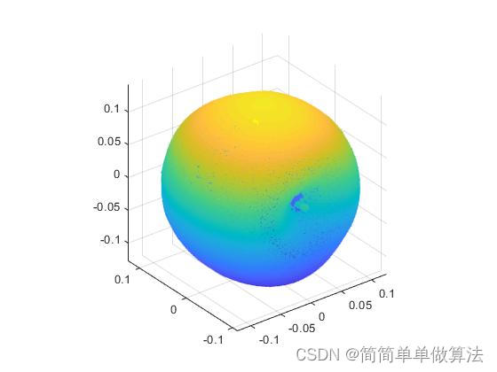

 %绘制拼接后的点云图像并保存数据
figure;
plot3(ALL(:,1),ALL(:,2),ALL(:,3),'.');
grid on
axis equal
xlabel('x');
ylabel('y');
zlabel('z');
%保存数据
Tri       = pointCloud(ALL);%将拼接后的点云数据保存为PLY格式
Tri.Normal = ALL_Normal;
% Tri          = pointCloud;
% Tri.Location = ALL;
% Tri.Color    = [];
% Tri.Normal   = ALL_Normal;
% Tri.Intensity= [];
% Tri.Count    = length(ALL);
% Tri.XLimits  = [min(ALL(:,1)) max(ALL(:,1))];
% Tri.YLimits  = [min(ALL(:,2)) max(ALL(:,2))];
% Tri.ZLimits  = [min(ALL(:,3)) max(ALL(:,3))];
pcwrite(Tri,'apple2.ply');
%在点云图像中显示拼接后的点云
pcshow(Tri);
