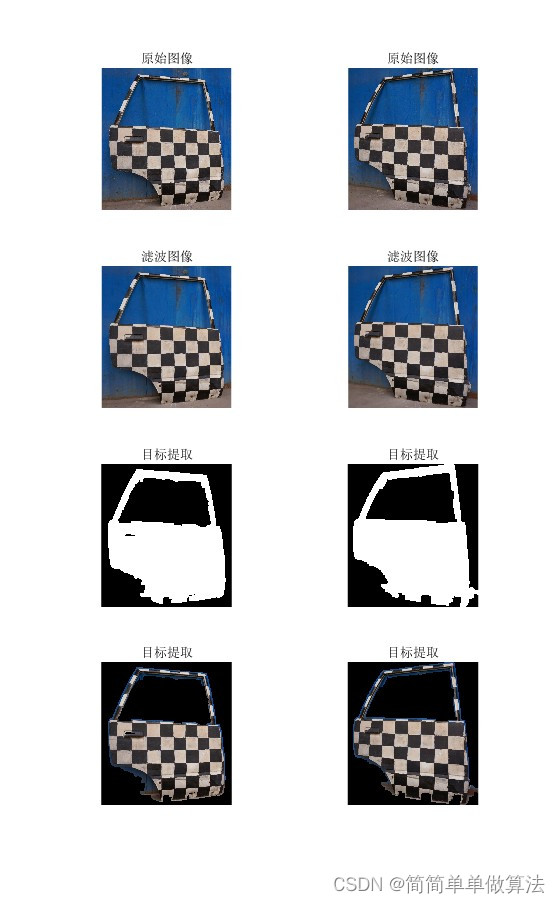

%2图像的预处理,比如增强,滤波,去背景等等,提取目标
I1f(:,:,1) = medfilt2(I1(:,:,1),[5,5]);
I1f(:,:,2) = medfilt2(I1(:,:,2),[5,5]);
I1f(:,:,3) = medfilt2(I1(:,:,3),[5,5]);
I2f(:,:,1) = medfilt2(I2(:,:,1),[5,5]);
I2f(:,:,2) = medfilt2(I2(:,:,2),[5,5]);
I2f(:,:,3) = medfilt2(I2(:,:,3),[5,5]);
subplot(423);
imshow(I1f);title('滤波图像');
subplot(424);
imshow(I2f);title('滤波图像');
[R,C,K] = size(I1f);
I1bg    = zeros(R,C);
I2bg    = zeros(R,C);
Thresh1 = 130;
Thresh2 = 70;
for i = 1:R
    for j = 1:C
        if I1f(i,j,1) >= Thresh1 & I1f(i,j,2) >= Thresh1 & I1f(i,j,3) >= Thresh1
           I1bg(i,j) = 1;
        end
        if I1f(i,j,1) <= Thresh2 & I1f(i,j,2) <= Thresh2 & I1f(i,j,3) <= Thresh2
           I1bg(i,j) = 1;
        end
        if I2f(i,j,1) >= Thresh1 & I2f(i,j,2) >= Thresh1 & I2f(i,j,3) >= Thresh1
           I2bg(i,j) = 1;
        end
        if I2f(i,j,1) <= Thresh2 & I2f(i,j,2) <= Thresh2 & I2f(i,j,3) <= Thresh2
           I2bg(i,j) = 1;
        end
    end
end
%去掉连通域小面积区域
I1bg    = double(bwareaopen(I1bg,20000));
I2bg    = double(bwareaopen(I2bg,20000));
SE=strel('square',20);
I1bgs   = imdilate(I1bg,SE);%图像
I2bgs   = imdilate(I2bg,SE);%图像
subplot(425);
imshow(I1bgs);title('目标提取');
subplot(426);
imshow(I2bgs);title('目标提取');
[R,C] = size(I1bg);
imgs1 = I1f;
imgs2 = I2f;
%根据提取出的目标,将图像中非目标区域置为0。
for i = 1:R
    for j = 1:C
        if I1bgs(i,j,1) == 0
           imgs1(i,j,:) = 0;
        end
        if I2bgs(i,j,1) == 0
           imgs2(i,j,:) = 0;
        end
    end
end
subplot(427);
imshow(imgs1);title('目标提取');
subplot(428);
imshow(imgs2);title('目标提取');

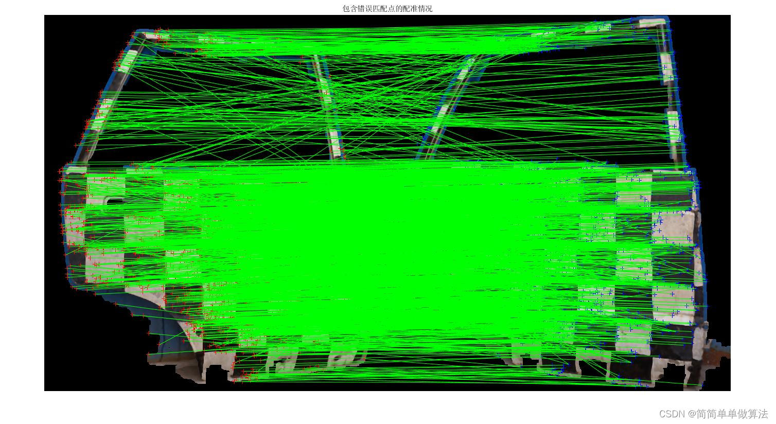

%去除错误配准点后的匹配效果显示匹配结果。
figure(2);
hIm     = montage([(img1s(1:L1,1:L2,:)),(img2s(1:L1,1:L2,:))]);
img2s2  = img2s(1:L1,1:L2,:);
hold on;
plot(Xs,Ys,'r+');
hold on;
plot(Xe,Ye,'b+');
hold on
for i = 1:length(Xs)
    line([Xs(i),Xe(i)],[Ys(i),Ye(i)],'color','g');
    hold on
end
title('包含错误匹配点的配准情况');
save step1.mat imgs1 imgs2 Xs Ys Xe Ye c1 X1 X2 Images1all Images2all
