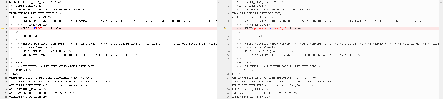

案例1:递归驱动分支没有FROM字句
原始语句
SELECT  T.RPT_ITEM_ID, --报表项ID
    T.RPT_ITEM_CODE,
    T.USER_GROUP_CODE AS USER_GROUP_CODE --用户组
FROM BIF.BIF_RPT_ITEM_DEF_T T,
(WITH recursive cte AS (
        SELECT DISTINCT TRIM(SUBSTR('' :: text, INSTR('', ',', 1, 1) + 1, INSTR('', ',', 1, 2) - INSTR('', ',', 1, 1) - 1)) AS cte_RPT_ITEM_CODE,
            1 AS level
        FROM (SELECT '') AS tb0
        UNION ALL
        SELECT DISTINCT TRIM(SUBSTR('' :: text, INSTR('', ',', 1, cte.level + 1) + 1, INSTR('', ',', 1, cte.level + 2) - INSTR('', ',', 1, cte.level + 1) - 1)),
            cte.level + 1
        FROM (SELECT '') AS tb0, cte
        WHERE cte.level + 1 <= LENGTH('') - LENGTH(REPLACE('', ',', '')) - 1
    SELECT
        DISTINCT cte_RPT_ITEM_CODE AS RPT_ITEM_CODE
    FROM cte
) T5
WHERE NVL(INSTR(T.RPT_ITEM_FREQUENCE, 'M'), 0) > 0
AND T.RPT_ITEM_CODE = NVL(T5.RPT_ITEM_CODE, T.RPT_ITEM_CODE)
AND T.RPT_ITEM_TYPE = 1 --是否是叶子报表项,1=是,0=否,基本报表项
AND T.ENABLE_FLAG = 1
AND T.VERSION = '202308' --使用快照,增加条件限制
ORDER BY T.RPT_ITEM_ID
改写语句
    T.RPT_ITEM_CODE,
            1 AS level
        FROM generate_series(1, 1) AS tb0
        UNION ALL
            cte.level + 1
    SELECT
    FROM cte
) T5
修改点比对

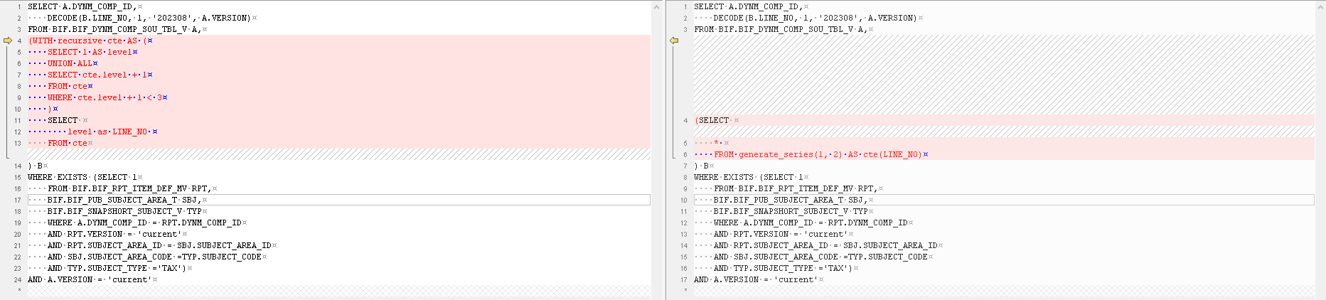

案例2:递归驱动分支没有FROM字句
原始语句
SELECT A.DYNM_COMP_ID,
    DECODE(B.LINE_NO, 1, '202308', A.VERSION)
FROM BIF.BIF_DYNM_COMP_SOU_TBL_V A,
    SELECT 1 AS level
    UNION ALL
    SELECT cte.level + 1
    FROM cte
    WHERE cte.level + 1 < 3
    SELECT
        level as LINE_NO
    FROM cte
) B
WHERE EXISTS (SELECT 1
    FROM BIF.BIF_RPT_ITEM_DEF_MV RPT,
    BIF.BIF_PUB_SUBJECT_AREA_T SBJ,
    BIF.BIF_SNAPSHORT_SUBJECT_V TYP
    WHERE A.DYNM_COMP_ID = RPT.DYNM_COMP_ID
    AND RPT.VERSION = 'current'
    AND RPT.SUBJECT_AREA_ID = SBJ.SUBJECT_AREA_ID
    AND SBJ.SUBJECT_AREA_CODE =TYP.SUBJECT_CODE
    AND TYP.SUBJECT_TYPE ='TAX')
AND A.VERSION = 'current'
改写语句
(SELECT
    FROM generate_series(1, 2) AS cte(LINE_NO)
) B
修改点比对

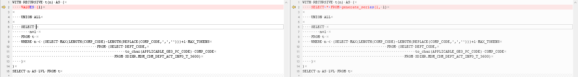

案例3:递归驱动分支是VALUES字句
原始语句
WITH RECURSIVE t(n) AS (
    VALUES (1)
    UNION ALL
    SELECT
        n+1
    FROM t
    WHERE n < (SELECT MAX(LENGTH(COMP_CODE)-LENGTH(REPLACE(COMP_CODE,',','')))+1 MAX_TOKENS
                                       FROM (SELECT DEPT_CODE,
                                                    to_char(APPLICABLE_GEO_PC_CODE) COMP_CODE
                                               FROM SDIHR.MDM_CDM_DEPT_ACT_INFO_T_3600)
SELECT n AS LVL FROM t
改写语句
    SELECT * FROM generate_series(1, 1)
    UNION ALL
    SELECT
        n+1
    FROM t
修改点比对

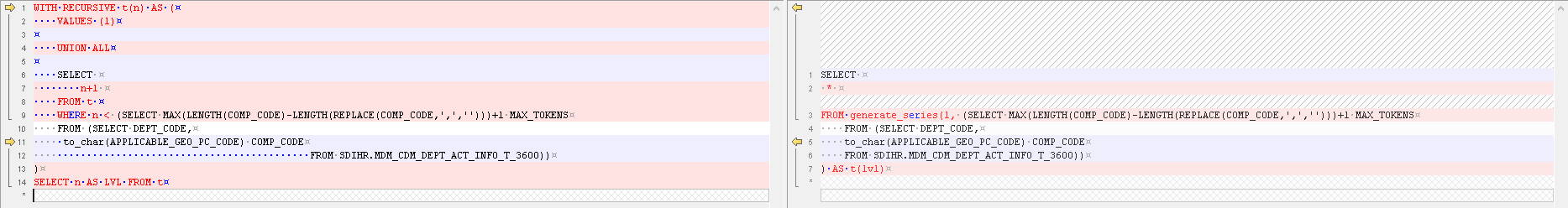

案例4:递归驱动分支是VALUES字句
原始语句
    VALUES (1)
    UNION ALL
    SELECT
        n+1
    FROM t
                                               FROM SDIHR.MDM_CDM_DEPT_ACT_INFO_T_3600))
改写语句
SELECT
FROM generate_series(1, (SELECT MAX(LENGTH(COMP_CODE)-LENGTH(REPLACE(COMP_CODE,',','')))+1 MAX_TOKENS
) AS t(lvl)
修改点比对

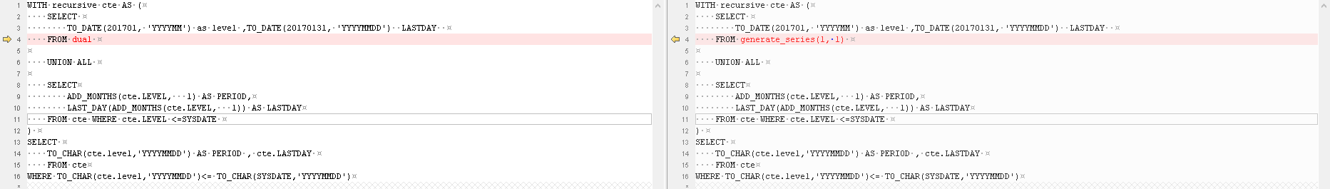

场景2:With-Recursive contains system table is not shippable
根因:递归语句的某个分支中没有FROM字句中只用系统表或者系统视图(DUAL也被视为系统视图)
案例1:递归驱动分支是FROM DUAL查询
原始语句
    SELECT
        TO_DATE(201701, 'YYYYMM') as level ,TO_DATE(20170131, 'YYYYMMDD')  LASTDAY
    FROM dual
    UNION ALL
    SELECT
        ADD_MONTHS(cte.LEVEL,   1) AS PERIOD,
        LAST_DAY(ADD_MONTHS(cte.LEVEL,   1)) AS LASTDAY
    FROM cte WHERE cte.LEVEL <=SYSDATE
SELECT
    TO_CHAR(cte.level,'YYYYMMDD') AS PERIOD , cte.LASTDAY
    FROM cte
WHERE TO_CHAR(cte.level,'YYYYMMDD')<= TO_CHAR(SYSDATE,'YYYYMMDD')
改写语句
    SELECT
    UNION ALL
    SELECT
SELECT
    FROM cte
修改点对比

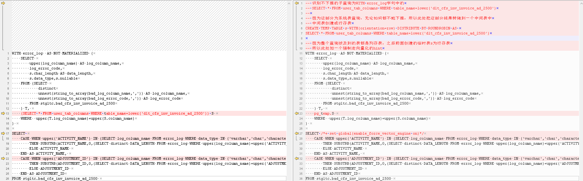

场景3:SubPlan exec on CN can't be shipped
根因:某个子查询语句只能在CN上执行,通常是这个子查询有不下推因素,比如有系统表、系统视图调用,或者存在不下推函数等
案例1:子查询中系统表/系统视图查询
原始语句
WITH error_log  AS NOT MATERIALIZED (
    SELECT
        upper(log_column_name) AS log_column_name,
        log_error_code,
        s.char_length AS data_length,
        s.data_type,s.nullable
    FROM (SELECT
            distinct
            unnest(string_to_array(bad_log_column_name,',')) AS log_column_name,
            unnest(string_to_array(bad_log_error_code,',')) AS log_error_code
        FROM stgltc.BAD_cfs_inv_invoice_ad_2500
    ) T,
    (SELECT * FROM user_tab_columns WHERE table_name=lower('dlt_cfs_inv_invoice_ad_2500')) S
    WHERE  upper(T.log_column_name)=upper(S.column_name)
SELECT
    CASE WHEN upper('ACTIVITY_NAME') IN (SELECT log_column_name FROM error_log WHERE data_type IN ('varchar','char','character','nchar','character varying','varchar2','nvarchar2','clob','text') AND log_error_code='22001'/*字符超长*/)
        THEN SUBSTRB(ACTIVITY_NAME,0,(SELECT distinct DATA_LENGTH FROM error_log WHERE upper(log_column_name)=upper('ACTIVITY_NAME')))
        ELSE ACTIVITY_NAME
    END AS ACTIVITY_NAME,
    CASE WHEN upper('ADJUSTMENT_ID') IN (SELECT log_column_name FROM error_log WHERE data_type IN ('varchar','char','character','nchar','character varying','varchar2','nvarchar2','clob','text') AND log_error_code='22001'/*字符超长*/)
        THEN SUBSTRB(ADJUSTMENT_ID,0,(SELECT distinct DATA_LENGTH FROM error_log WHERE upper(log_column_name)=upper('ADJUSTMENT_ID')))
        ELSE ADJUSTMENT_ID
    END AS ADJUSTMENT_ID
改写语句
-- 识别不下推的子查询为WITH error_log字句中的
-- SELECT * FROM user_tab_columns WHERE table_name=lower('dlt_cfs_inv_invoice_ad_2500')
-- 因为这部分为系统表查询,无论如何都不能下推,所以此处把这部分结果转储到一个中间表中
-- 中间表创建成行存表
CREATE TEMP TABLE s WITH(orientation=row) DISTRIBUTE BY ROUNDROBIN AS
-- 因为整个查询涉及到的表都是列存表,之后前面创建的临时表s为行存表
-- 所以此处加一个强制走向量化的hint
    SELECT
        log_error_code,
    FROM (SELECT
            distinct
        FROM stgltc.bad_cfs_inv_invoice_ad_2500
    ) T,
    pg_temp.S
SELECT /*+ set global(enable_force_vector_engine on)*/
        ELSE ACTIVITY_NAME
        ELSE ADJUSTMENT_ID
修改点对比

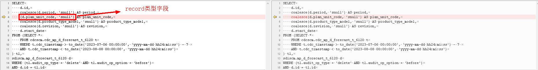

案例1:输出列书写错误,出现(...)形式的输出列
原始语句
SELECT
    d.id,
    coalesce(d.period, 'snull') AS period,
    (d.plan_unit_code, 'snull') AS plan_unit_code,
    coalesce(d.product_type_model, 'snull') AS product_type_model,
    coalesce(d.revision, 'snull') AS revision,
    d.start_date
FROM (SELECT *
    FROM cdcscm.cdc_mp_d_forecast_t_6120 t
    WHERE t.cdc_timestamp > to_date('2023-07-06 00:00:00', 'yyyy-mm-dd hh24:mi:ss') - 7
    AND t.cdc_timestamp < to_date('2023-08-08 00:00:00', 'yyyy-mm-dd hh24:mi:ss')
) t1,
sdiscm.mp_d_forecast_t_6120 d
WHERE (t1.audit_op_type = 'delete' AND t1.audit_op_option = 'before')
AND d.id = t1.id
改写语句
SELECT
    d.id,
    coalesce(d.plan_unit_code, 'snull') AS plan_unit_code,
    d.start_date
FROM (SELECT *
) t1,
AND d.id = t1.id
修改点对比
备注:改写前后语句不等价,不等价的原因是因为原始SQL书写有问题,正确的写法是就是coalesce(d.plan_unit_code, 'snull') AS plan_unit_code

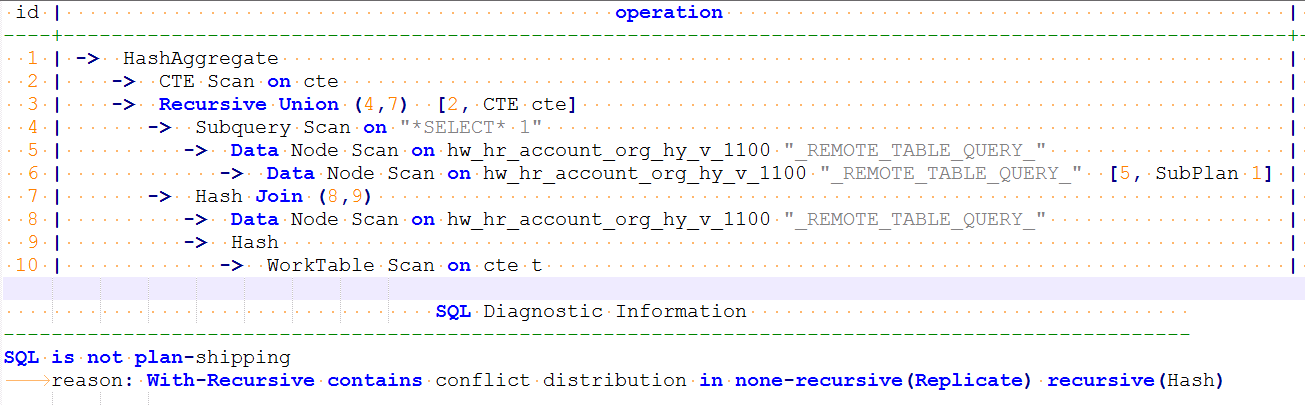

场景8:With-Recursive contains conflict distribution in none-recursive(xxx) recursive(xxx)
不下推根因:非递归部分语句(UNION ALL前面部分)的执行计划为replicate计划,递归部分语句(UNION ALL后面部分)的执行计划为Hash计划,计划存在冲突
处理方案:把非递归部分语句转储为临时表,临时表的分布形式和计划的分布式不一致即可
案例1:非递归部分语句的执行计划为replicate计划
原始语句:
WITH RECURSIVE CTE AS (
    SELECT
        AOH.ORG_CODE,1 AS LEVEL,
        1 FLAG,
        LAST_UPDATE_DATE
    FROM SDIHR.HW_HR_ACCOUNT_ORG_HY_V_1100 AOH
    WHERE AOH.ORG_CODE IN (SELECT V.ORG_CODE
        FROM SDIHR.HW_HR_ACCOUNT_ORG_HY_V_1100 V
        WHERE V.ORG_CODE IS NOT NULL
        AND AOH.ORG_CODE = V.ORG_CODE
    UNION ALL
    SELECT
      AOH.ORG_CODE,T.LEVEL + 1 AS LEVEL,
      1 FLAG,
      AOH.LAST_UPDATE_DATE
    INNER JOIN CTE T ON T.ORG_CODE = AOH.PARENT_ORG_CODE
SELECT
    ORG_CODE,
    MAX(LEVEL) -1 AS AOH_LEVEL,
    1 FLAG,
    LAST_UPDATE_DATE AS LAST_UPDATE_DATE1
FROM CTE
GROUP BY ORG_CODE, LAST_UPDATE_DATE
SQL自诊断信息
