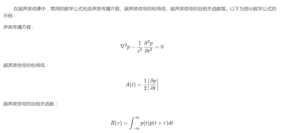

1.4数学公式的使用
1.5成像性能评估

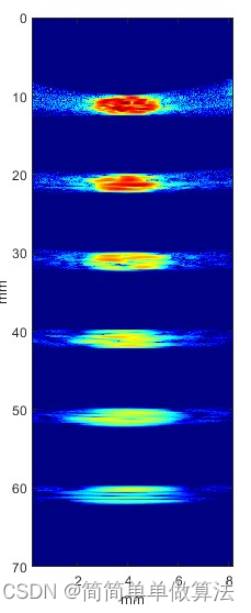

%% Total focusing method
 tic
image = tfm12(fmc, domain);
toc
%% Plot image
% transform data to dB scale
normalize = @(x) x./max(x(:));
fun = @(x) 20*log10(normalize(abs(x)));
% dB range in image
dB = [-60,0];
X = image.xRange*1000;
Y = image.zRange*1000;
Z = fun(image.image);
figure
imagesc(X,Y,Z,dB)
xlabel('mm')
ylabel('mm')
colormap('jet')
save data.mat X Y Z dB
