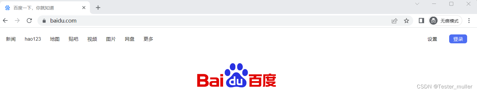

我们都知道,Chrome和edge都是使用的chromium内核,因此我们只需要再加一个chanel参数即可,如果我们要打开Chrome浏览器,则参数为channel="chrome",示例如下:
from playwright.sync_api import sync_playwright
with sync_playwright() as pw:
    browser = pw.chromium.launch(headless=False, channel="chrome")
    page = browser.new_page()
    page.goto("https://www.baidu.com/")
    page.pause()
运行脚本,浏览器界面如下:

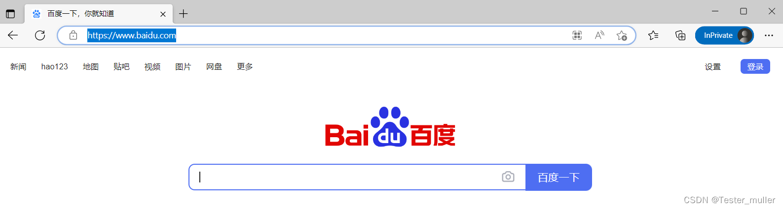

同理,要打开edge浏览器,添加channel="msedge"参数即可,代码如下:
    browser = pw.chromium.launch(headless=False, channel="msedge")
    page.pause()
运行脚本,打开的浏览器页面如下:
