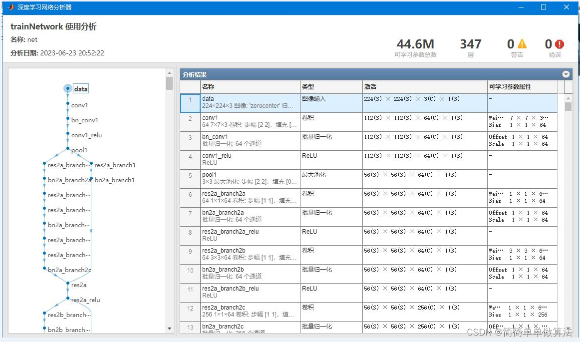

analyzeNetwork(net)

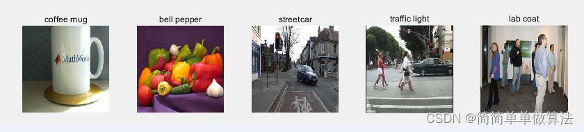

img1 = imread("images\1.png");
img1 = imresize(img1,[224 224]);
img2 = imread("images\2.png");
img2 = imresize(img2,[224 224]);
img3 = imread("images\3.jpg");
img3 = imresize(img3,[224 224]);
img4 = imread("images\4.jpg");
img4 = imresize(img4,[224 224]);
img5 = imread("images\5.jpg");
img5 = imresize(img5,[224 224]);
label1 = classify(net,img1);
label2 = classify(net,img2);
label3 = classify(net,img3);
label4 = classify(net,img4);
label5 = classify(net,img5);
figure
subplot(151);
imshow(img1)
title(string(label1))
subplot(152);
imshow(img2)
title(string(label2))
subplot(153);
imshow(img3)
title(string(label3))
subplot(154);
imshow(img4)
title(string(label4))
subplot(155);
imshow(img5)
title(string(label5))
