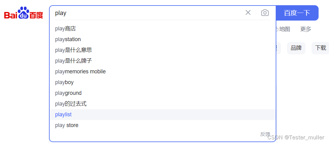

  1. 选择和删除文本
from playwright.sync_api import sync_playwright
def key_option():
    with sync_playwright() as playwright:
        browser = playwright.chromium.launch(headless=False)
        context = browser.new_context()
        page = context.new_page()
        page.goto("https://www.baidu.com/")
        page.locator("#kw").click()
        page.keyboard.type("playwright")
        page.keyboard.down("Shift")
        for i in range(6):
            page.keyboard.press("ArrowLeft")
        page.keyboard.up("Shift")
        page.keyboard.press("Backspace")
        page.pause()
        context.close()
        browser.close()
key_option()
运行脚本之后,playwright的文本中后面6个字母被删除,结果如下图所示:

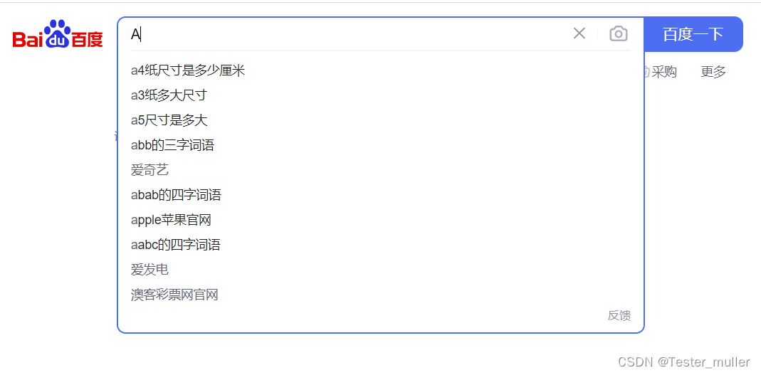

  1. 输入大写字母
def key_option():
        page.keyboard.press("Shift+KeyA")
        page.pause()
        context.close()
        browser.close()
key_option()
运行脚本,界面如下图所示:
注:使用Shift+A一样可以按出大写字母A

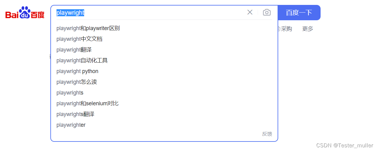

  1. 全选操作
def key_option():
        page.keyboard.press("Control+A")
        page.pause()
        context.close()
        browser.close()
key_option()
运行脚本之后,界面如下所示:
注:Mac系统的键盘操作为‘Meta+A’

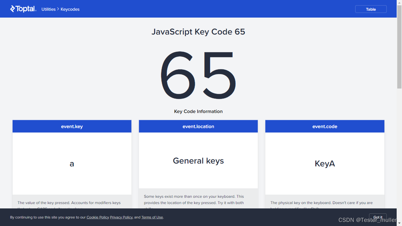

press 长按
key可以指定预期的keyboardEvent.key值或单个字符来为其生成文本。可以在此处key找到这些值的超集。键的例子是:F1- F12, Digit0- Digit9, KeyA- KeyZ, Backquote, Minus, Equal, Backslash, Backspace, Tab, Delete, Escape, ArrowDown, End, Enter,Insert等
示例代码:
def key_option():
        page.goto("https://keycode.info")
        page.keyboard.press("a")
        page.screenshot(path="a.png")
        page.screenshot(path="arrow_left.png")
        page.keyboard.press("Shift+O")
        page.screenshot(path="o.png")
        page.pause()
        context.close()
        browser.close()
key_option()
运行脚本,截取的图片如下:

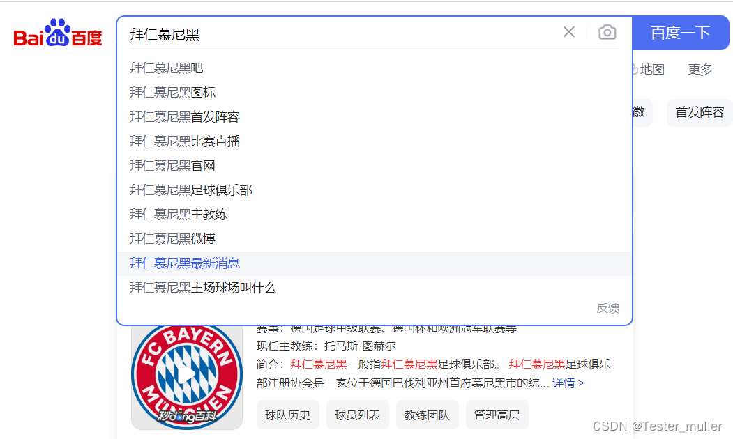

Type 操作
为文本中的每个字符发送keydown、keypress/input和事件。
示例如下:
def key_option():
        page.keyboard.type("拜仁")
        page.keyboard.type("慕尼黑", delay=100)
        page.pause()
        context.close()
        browser.close()
key_option()
运行脚本,结果如下图:
