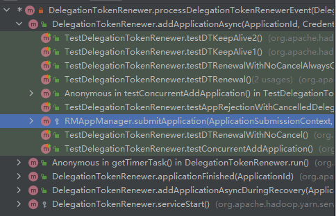

以作业提交阶段为例,核心调用链如下:
RMAppManager.submitApplication()
—DelegationTokenRenewer.addApplicationAsync()
------DelefationTokenRenewer.processDelegationTokenRenewerEvent()

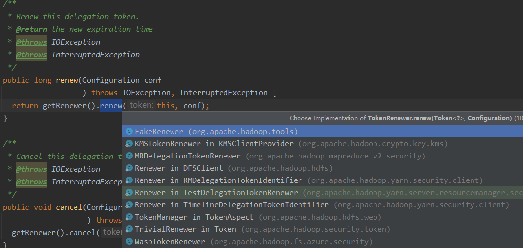

刷新Token到底是做了什么事情:
protected void renewToken(final DelegationTokenToRenew dttr) throws IOException { // need to use doAs so that http can find the kerberos tgt // NOTE: token renewers should be responsible for the correct UGI! try { dttr.expirationDate = UserGroupInformation.getLoginUser().doAs( new PrivilegedExceptionAction<Long>() { @Override public Long run() throws Exception { return dttr.token.renew(dttr.conf); } }); } catch (InterruptedException e) { throw new IOException(e); } LOG.info("Renewed delegation-token= [" + dttr + "]"); }
可以看到刷新token的逻辑很简单
1-将dttr.expirationDate更新了下。
2-将dttr.token中的生存周期也进行更新;
3-根据token刷新时间的Renewer给相应的服务发送renewer rpc请求;namenode, resourcemanager,timelineserver等服务的内存中以及各自的持久化方式存储token,renewer之后会将其进行更新,这样当客户端携带token信息来认证的时候就不会过期了
