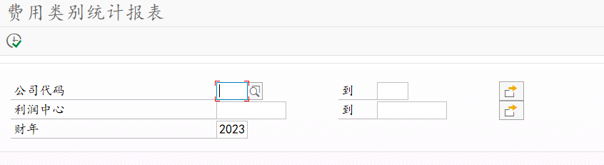

接到一个需求对公司的费用类别作统计,要求选择屏幕如下:

选择屏幕部分
接下来定义 ALV 中需要显示的字段,主要包括选择屏幕和选项,结束选择屏幕后的数据读取操作:
* Selection Screen
SELECTION-SCREEN BEGIN OF BLOCK y1 WITH FRAME TITLE TEXT-001.
SELECT-OPTIONS:
  so_bukrs FOR bseg-bukrs,
  so_prctr FOR bseg-prctr.
PARAMETERS: p_gjahr LIKE bseg-gjahr OBLIGATORY DEFAULT sy-datlo(4).
SELECTION-SCREEN END OF BLOCK y1.

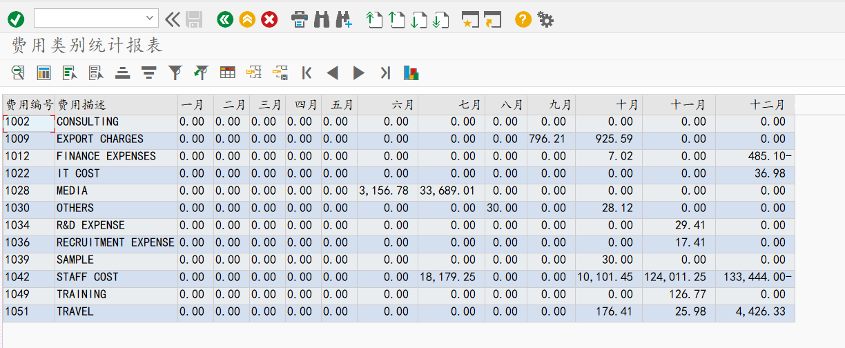

然后按照月份求和:
LOOP AT gt_total1 INTO gs_total1.
    AT NEW zcode_cost.
      lv_zcode_cost = gs_total1-zcode_cost.
    ENDAT.
    IF lv_zcode_cost EQ gs_total1-zcode_cost AND gs_total1-h_monat EQ 01.
      gs_out-month_1 = gs_out-month_1 + gs_total1-dmbtr.
      gs_out-zcode_cost = gs_total1-zcode_cost.
      gs_out-zcost_desc = gs_total1-zcost_desc.
    ELSEIF lv_zcode_cost EQ gs_total1-zcode_cost AND gs_total1-h_monat EQ 02.
      gs_out-month_2 = gs_out-month_2 + gs_total1-dmbtr.
    ELSEIF lv_zcode_cost EQ gs_total1-zcode_cost AND gs_total1-h_monat EQ 03.
      gs_out-month_3 = gs_out-month_3 + gs_total1-dmbtr.
    ELSEIF lv_zcode_cost EQ gs_total1-zcode_cost AND gs_total1-h_monat EQ 04.
      gs_out-month_4 = gs_out-month_4 + gs_total1-dmbtr.
    ELSEIF lv_zcode_cost EQ gs_total1-zcode_cost AND gs_total1-h_monat EQ 05.
      gs_out-month_5 = gs_out-month_5 + gs_total1-dmbtr.
    ELSEIF lv_zcode_cost EQ gs_total1-zcode_cost AND gs_total1-h_monat EQ 06.
      gs_out-month_6 = gs_out-month_6 + gs_total1-dmbtr.
    ELSEIF lv_zcode_cost EQ gs_total1-zcode_cost AND gs_total1-h_monat EQ 07.
      gs_out-month_7 = gs_out-month_7 + gs_total1-dmbtr.
    ELSEIF lv_zcode_cost EQ gs_total1-zcode_cost AND gs_total1-h_monat EQ 08.
      gs_out-month_8 = gs_out-month_8 + gs_total1-dmbtr.
    ELSEIF lv_zcode_cost EQ gs_total1-zcode_cost AND gs_total1-h_monat EQ 09.
      gs_out-month_9 = gs_out-month_9 + gs_total1-dmbtr.
    ELSEIF lv_zcode_cost EQ gs_total1-zcode_cost AND gs_total1-h_monat EQ 10.
      gs_out-month_10 = gs_out-month_10 + gs_total1-dmbtr.
    ELSEIF lv_zcode_cost EQ gs_total1-zcode_cost AND gs_total1-h_monat EQ 11.
      gs_out-month_11 = gs_out-month_11 + gs_total1-dmbtr.
    ELSEIF lv_zcode_cost EQ gs_total1-zcode_cost AND gs_total1-h_monat EQ 12.
      gs_out-month_12 = gs_out-month_12 + gs_total1-dmbtr.
    ENDIF.
    AT END OF zcode_cost.
      APPEND gs_out TO gt_out.
      CLEAR:gs_out.
    ENDAT.
    CLEAR: gs_total1.
  ENDLOOP.

运行结果
报表执行结果:

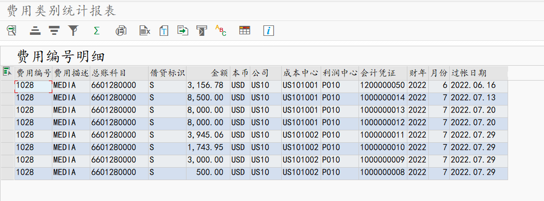

然后点击单独的月份,可以查看当前费用编号的明细信息:
