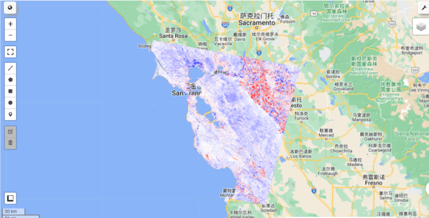

这里我们加载landsat 5的影像,然后进行NDVI的单景计算,这里分别查看20年的差异的对比,值得注意的是我们这里需要使用getNDVI(image1)来分别获取相应的NDVI影像,这个不同于select函数,所以我们值得注意和JavaScript的差异。另外这里使用到的函数:

# Add Earth Engine dataset
# This function gets NDVI from Landsat 5 imagery.
def getNDVI(image):
    return image.normalizedDifference(['B4', 'B3'])
# Load two Landsat 5 images, 20 years apart.
image1 = ee.Image('LANDSAT/LT05/C01/T1_TOA/LT05_044034_19900604')
image2 = ee.Image('LANDSAT/LT05/C01/T1_TOA/LT05_044034_20100611')
# Compute NDVI from the scenes.
ndvi1 = getNDVI(image1)
ndvi2 = getNDVI(image2)
# Compute the difference in NDVI.
ndviDifference = ndvi2.subtract(ndvi1)
# Load the land mask from the SRTM DEM.
landMask = ee.Image('CGIAR/SRTM90_V4').mask()
# Update the NDVI difference mask with the land mask.
maskedDifference = ndviDifference.updateMask(landMask)
# Display the masked result.
vizParams = {'min': -0.5, 'max': 0.5,
             'palette': ['FF0000', 'FFFFFF', '0000FF']}
Map.setCenter(-122.2531, 37.6295, 9)
Map.addLayer(maskedDifference, vizParams, 'NDVI difference')
最终结果如下:
