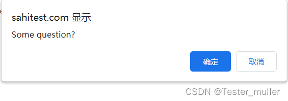

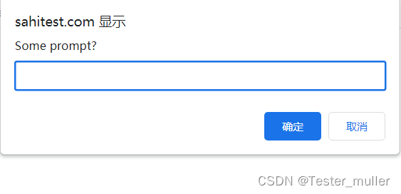

弹框通常分为3种,分别为alert,confirm,promot。
  • alert弹框:只有信息和确定按键
  • confirm弹框:在alert弹窗基础上增加了取消按钮
  • prompt弹框:在confirm的基础上增加了可输入文本内容的功能
图像分别如下:

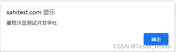

    # 没监听时,它自动会关闭
    page.evaluate("alert('霍格沃兹测试开发学社')")
    browser.close()
with sync_playwright() as playwright:
    run(playwright)

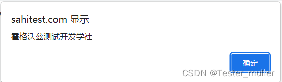

当监听器存在时,它必须dialog.accept()或dialog.dismiss()对话框 - 否则页面将冻结等待对话框,并且单击等操作将永远不会完成。
from playwright.sync_api import sync_playwright
def handle_dialog(dialog):
    """监听后处理"""
    print(dialog.message)
    dialog.dismiss()
def run(playwright):
    chromium = playwright.chromium
    browser = chromium.launch(headless=False, slow_mo=3000)
    page = browser.new_page()
    page.on("dialog", handle_dialog)
    browser.close()
    run(playwright)
通过page.on(“dialog”, handler) 监听到dialog 事件,可以获取到dialog.message内容。
