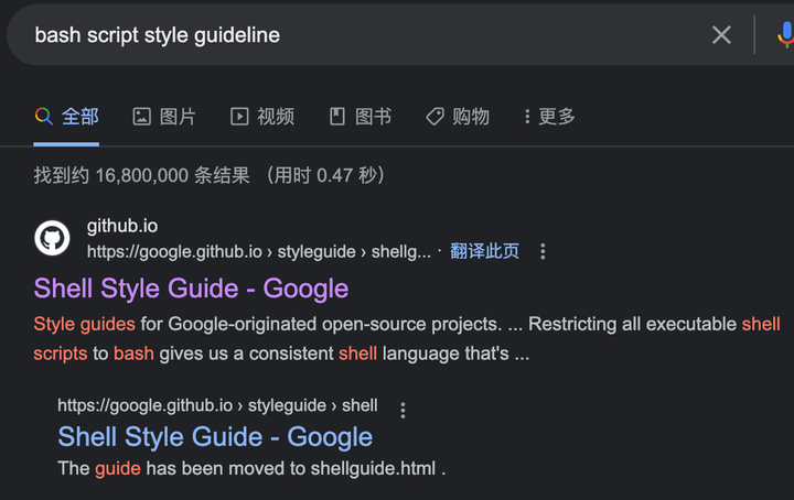

然后我搜索 “bash script style guideline”,最上面的结果是:
即代码规范:https://google.github.io/styleguide/shellguide.html
我仔细阅读了这份风格指南,对其中的“局部变量”的章节很感兴趣。

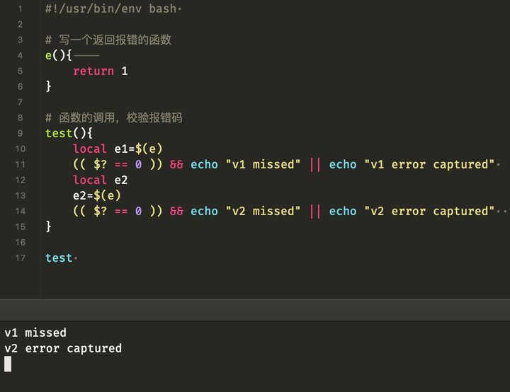

文中说:「最好把局部变量的定义与赋值,换行实现,不要写到同一行上」,以免掩盖报错状态码。
原文
Declare function-specific variables with local. Declaration and assignment should be on different lines.
Ensure that local variables are only seen inside a function and its children by using local when declaring them. This avoids polluting the global name space and inadvertently setting variables that may have significance outside the function.
Declaration and assignment must be separate statements when the assignment value is provided by a command substitution; as the local builtin does not propagate the exit code from the command substitution.
我动手验证这个细节,发现果然如此:

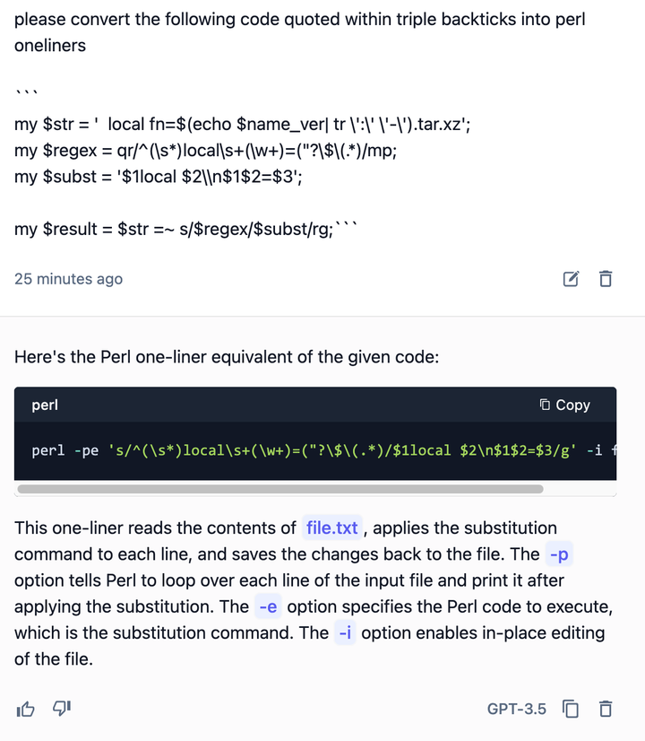

精简为 perl_oneliner:
perl -pe 's/^(\s*)local\s+(\w+)=("?\$\(.*)/$1local $2\n$1$2=$3/g' -i file.txt
