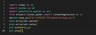

通过散点图把数据给可视化
散点图代码

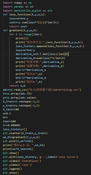

根据在最小二乘法中,均方误差函数的数学表达式,刻画的是每个点的y和拟合出来的直线y撇的差距:
均方误差函数(MSE)代码如下:
计算初始情况下的cost,进行100次学习之后,最终确定线性方程:
算法代码如下:
线性回归结果图
检验损失代码
运行结果如下图所示:
3.3 源码
源码:
import numpy as np
import pandas as pd
def loss_function(X,y,w,b):
    loss=w*X+b-y
    cost=np.sum(loss**2)/(2*len(X))
    return cost
def gradient(X,y,w,b):
    for i in range(iter):
        print(i)
        print("现在损失是:",loss_function(X,y,w,b))
        loss_history.append(loss_function(X,y,w,b))
        loss=w*X+b-y
        derivative_w=X.T.dot(loss)/len(X)
        derivative_b=sum(loss)*1/len(X)
        print("权重导数:",derivative_w)
        print("偏置导数:",derivative_b)
        w=w-lr*derivative_w
        print("现在w:",w)
        b=b-lr*derivative_b
        print("现在b:",b)
    return w,b
adv=pd.read_csv("D:\\浏览器下载\\advertising.csv")
X=np.array(adv.TV)
y=np.array(adv.sales)
X_train=X.reshape(-1,1)
y_train=y.reshape(-1,1)
X_test=100
w=0.1
b=1
iter=100
lr=0.000002
loss_history=[]
plt.scatter(X_train,y_train)
w1,b1=gradient(X,y,w,b)
plt.plot(X,w1*X+b1)
print("最后w,b 是:",w1,b1)
print(w1*X_test+b1)
plt.show()
plt.plot(loss_history,'g--',label='Loss Curve')
plt.xlabel('Iterations')
plt.ylabel('Loss')
plt.legend()
plt.show()
