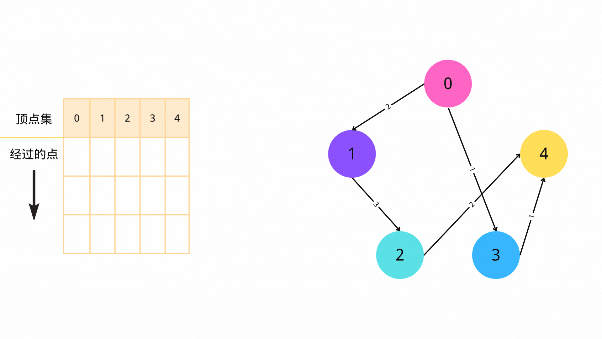

        // 构造图
        Graph graph = new Graph();
        // 构造顶点
        Vertex s = new Vertex(0);
        Vertex a = new Vertex(1);
        Vertex b = new Vertex(2);
        Vertex c = new Vertex(3);
        Vertex d = new Vertex(4);
        // 点加边
        s.addEdge(new Edge(s, a, 2));
        s.addEdge(new Edge(s, c, 1));
        a.addEdge(new Edge(a, b, 3));
        b.addEdge(new Edge(b, d, 2));
        c.addEdge(new Edge(c, d, 1));
        // 边加点
        graph.addVertex(s);
        graph.addVertex(a);
        graph.addVertex(b);
        graph.addVertex(c);
        graph.addVertex(d);
        // 调用SPFA算法求解最短路径
        spfa(graph, s);
        // 输出结果
        for (Vertex v :graph.getVertices()) {
            System.out.println("Shortest distance from source to vertex " + v.getId() + " is " + v.getDistance());
