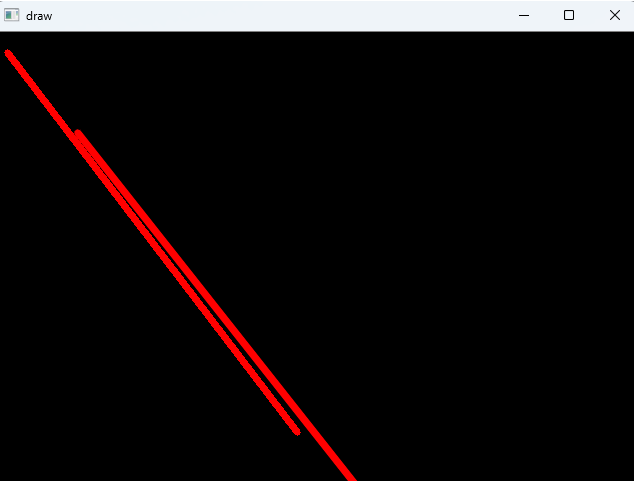

img = np.zeros((480,640,3),np.uint8)
line(img,pt1,pt2,color,thickness,lineType,shift)
cv2.line(img,(10,20),(300,400),(0,0,255),5,4)
cv2.line(img,(80,100),(380,480),(0,0,255),5,16)
显示图像
cv2.imshow('draw',img)
释放窗口
cv2.waitKey(0)
cv2.destroyAllWindows()
效果显示
完整学习代码
import cv2
import numpy as np
cv2.waitKey(0)
