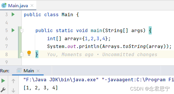

方法1:
        int[] array={1,2,3,4};
        System.out.println(Arrays.toString(array));
代码的运行结果为:

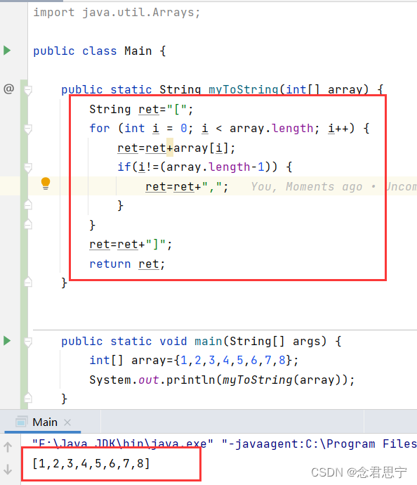

方法2:
    public static String myToString(int[] array) {
        String ret="[";
        for (int i = 0; i < array.length; i++) {
            ret=ret+array[i];
            if(i!=(array.length-1)) {
                ret=ret+",";
        ret=ret+"]";
        return ret;
        int[] array={1,2,3,4,5,6,7,8};
        System.out.println(myToString(array));
代码的运行结果为:

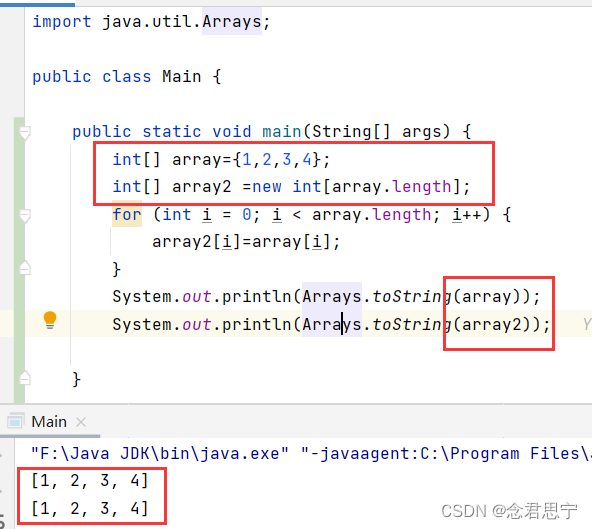

方法1:
        int[] array2 =new int[array.length];
            array2[i]=array[i];
        System.out.println(Arrays.toString(array2));
代码的运行结果为:

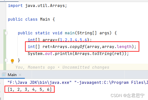

public class Main {
        int[] array={1,2,3,4,5,6};
        int[] ret=Arrays.copyOf(array,array.length);
        System.out.println(Arrays.toString(ret));
代码的运行结果为:

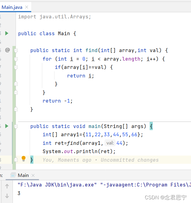

 3.查找数组中的指定元素
    public static int find(int[] array,int val) {
            if(array[i]==val) {
                return i;
        return -1;
        int[] array1={11,22,33,44,55,66};
        int ret=find(array1,44);
        System.out.println(ret);
代码的运行结果为:

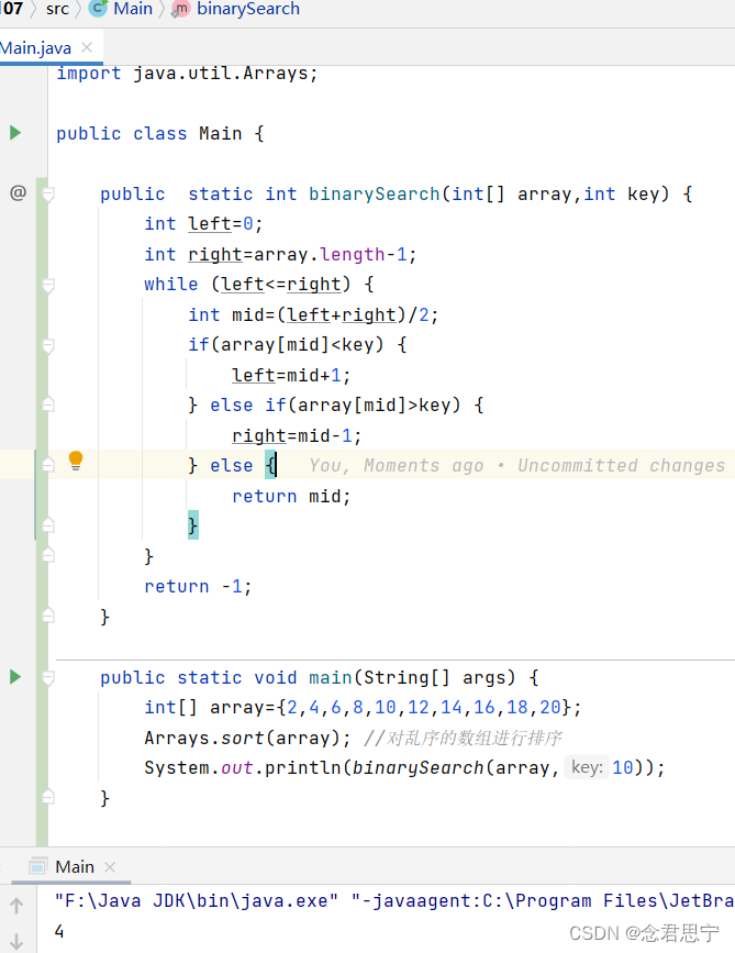

 4.二分查找:给定一个有序数组,实现二分查找
    public  static int binarySearch(int[] array,int key) {
        int left=0;
        int right=array.length-1;
        while (left<=right) {
            int mid=(left+right)/2;
            if(array[mid]<key) {
                left=mid+1;
            } else if(array[mid]>key) {
                right=mid-1;
            } else {
                return mid;
        return -1;
        int[] array={2,4,6,8,10,12,14,16,18,20};
        Arrays.sort(array); //对乱序的数组进行排序
        System.out.println(binarySearch(array,10));
代码的运行结果为:
