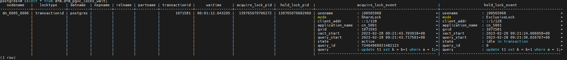

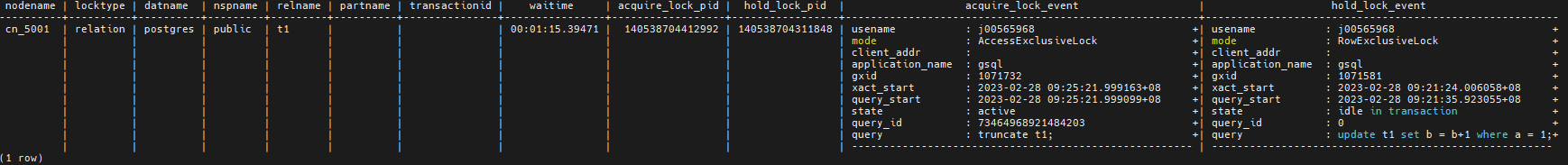

【解决方案】基于版本(8.1.3及以上版本)当前具有的锁等待监控能力,做以下优化,并且把新的视图定义封装成视图
  1. 优化显式信息,信息显示更聚焦&直观
  2. 只输出申请锁时长大于30s的,以减小输出记录的条数,便于分析
  3. 脚本部署需要使用超户,否则定时任务调度的时候会因为权限问题导致部分字段显示异常,导致监控信息分析结果异常
在要监控的database中创建锁等待监控&分析视图,定义如下

SELECT
    t1.nodename,
    t1.locktype,
    t1.datname,
    t1.nspname,
    t1.relname,
    t1.partname,
    (now()::timestamp-t1.xact_start::timestamp) AS waitime,
    t1.gxid AS acquire_gxid,
    t1.query_id AS acquire_queryid,
    t1.pid AS acquire_lock_pid,
    t2.gxid AS hold_gxid,
    t2.query_id AS hold_queryid,
    t2.pid AS hold_lock_pid,
        ''usename           : '' || t1.usename  || E''\n'' ||
        ''mode              : '' || t1.mode || E''\n'' ||
        ''client_addr       : '' || t1.client_addr || E''\n'' ||
        ''application_name  : '' || t1.application_name || E''\n'' ||
        ''gxid              : '' || t1.gxid || E''\n'' ||
        ''xact_start        : '' || t1.xact_start || E''\n'' ||
        ''query_start       : '' || t1.query_start || E''\n'' ||
        ''state             : '' || t1.state || E''\n'' ||
        ''query_id          : '' || t1.query_id || E''\n'' ||
        ''query             : '' || t1.query || E''\n'' ||
    ) AS acquire_lock_event,
        ''usename           : '' || t2.usename  || E''\n'' ||
        ''mode              : '' || t2.mode || E''\n'' ||
        ''client_addr       : '' || t2.client_addr || E''\n'' ||
        ''application_name  : '' || t2.application_name || E''\n'' ||
        ''gxid              : '' || t2.gxid || E''\n'' ||
        ''xact_start        : '' || t2.xact_start || E''\n'' ||
        ''query_start       : '' || t2.query_start || E''\n'' ||
        ''state             : '' || t2.state || E''\n'' ||
        ''query_id          : '' || t2.query_id || E''\n'' ||
        ''query             : '' || t2.query || E''\n'' ||
    ) AS hold_lock_event
FROM lock_info t1
JOIN lock_info t2 ON (t1.lockFlag = t2.lockFlag AND t1.granted = false AND t2.granted = true)
JOIN lock_mode_conflicts lc ON (t1.mode = lc.lock_mode_1 AND t2.mode = lc.lock_mode_2)
;') AS(

9.1.0以及上的版本因为在pg_locks里面记录了申请锁以及持有锁的时间,视图定义可以优化到如下定义
CREATE  OR REPLACE VIEW public.dfm_pgxc_locks_wait AS

1.1)事务锁信息样例如下,显著的标记为locktype字段为值为transactionid
这表示在
  1. 实例dn_6005_6006上的库postgres里面探测到事务锁(transactionid)等待
  2. 导致锁等待的事务的事务id是1071581,持锁线程pid为139765079682960,申请锁线程的pid为139765079706272,申请锁线程的事务已经运行1min 12s
  3. 分析acquire_lock_event和hold_lock_event,可以发现是因为表t1并发更新同一个元组(或者CU)导致的,事务1071581的更新动作已经发生(hold lock),事务1071593在等待事务1071581提交
只有当事务1071581提交之后,事务1071593的UPDATE语句才能继续执行

1.2) 表级锁输出信息样例如下,显著的标记为locktype字段为值为relation,类似的分区锁显著的标记为locktype字段为值为partition
这表示
  1. 实例cn_5001上的库postgres中探测到表public.t1上的表级锁(relation)导致的等待
  2. 持锁线程pid为140538704311848,申请锁线程的pid为140538704412992,申请锁线程的事务已经运行1min 15s
  3. 分析acquire_lock_event和hold_lock_event,可以发现是因为表t1的update和truncate并发,申请锁线程140538704412992的因为truncate动作正在申请AccessExclusiveLock,持锁线程140538704311848因为update动作持有表t1的RowExclusiveLock;二者锁动作互斥,导致truncate动作产生等待。
这种场景需要修改作业的调度逻辑或者依赖关系,把产生长时间等待的作业修改为串行,避免某些做业务长时间等待
