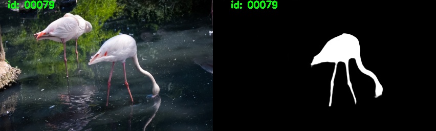

2.4 测试模型
# Testing Phase
if vis_res:
    plt.close("all")
    plt.ion()
    f, ax_arr = plt.subplots(1, 3)
save_dir_res = os.path.join(save_dir, 'Results', seq_name)  # 图片测试结果保存路径
if not os.path.exists(save_dir_res):
    os.makedirs(save_dir_res)
print('Testing Network')
with torch.no_grad():  # PyTorch 0.4.0 style
    # Main Testing Loop
    for ii, sample_batched in enumerate(testloader):
        img, gt, fname = sample_batched['image'], sample_batched['gt'], sample_batched['fname']
        # Forward of the mini-batch
        inputs, gts = img.to(device), gt.to(device)
        outputs = net.forward(inputs)
        for jj in range(int(inputs.size()[0])):
            pred = np.transpose(outputs[-1].cpu().data.numpy()[jj, :, :, :], (1, 2, 0))
            pred = 1 / (1 + np.exp(-pred))
            pred = np.squeeze(pred)
            # Save the result, attention to the index jj
            sm.imsave(os.path.join(save_dir_res, os.path.basename(fname[jj]) + '.png'), pred)
            if vis_res:
                img_ = np.transpose(img.numpy()[jj, :, :, :], (1, 2, 0))
                gt_ = np.transpose(gt.numpy()[jj, :, :, :], (1, 2, 0))
                gt_ = np.squeeze(gt)
                # Plot the particular example
                ax_arr[0].cla()
                ax_arr[1].cla()
                ax_arr[2].cla()
                ax_arr[0].set_title('Input Image')
                ax_arr[1].set_title('Ground Truth')
                ax_arr[2].set_title('Detection')
                ax_arr[0].imshow(im_normalize(img_))
                ax_arr[1].imshow(gt_)
                ax_arr[2].imshow(im_normalize(pred))
                plt.pause(0.001)

2.5 查看视频分割结果
src_dir = './video_object_segmention/OSVOS-PyTorch/DAVIS_2016/JPEGImages/480p/flamingo'
result_dir = './video_object_segmention/OSVOS-PyTorch/./models/Results/flamingo'
files = os.listdir(result_dir)
files.sort()
for file_name in files:
    clear_output(wait=True)
    src_img = cv2.imread(os.path.join(src_dir, file_name.split('.')[0] + '.jpg'))
    result_img = cv2.imread(os.path.join(result_dir, file_name))
    src_img = cv2.resize(src_img, (416, 256), interpolation=cv2.INTER_AREA)
    result_img = cv2.resize(result_img, (416, 256), interpolation=cv2.INTER_AREA)
    cv2.putText(src_img, 'id: ' + str(file_name.split('.')[0]), (15, 15), cv2.FONT_HERSHEY_SIMPLEX, 0.6, (0, 255, 0), 2)  # 画frame_id
    cv2.putText(result_img, 'id: ' + str(file_name.split('.')[0]), (15, 15), cv2.FONT_HERSHEY_SIMPLEX, 0.6, (0, 255, 0), 2)  # 画frame_id
    img_show = np.hstack((src_img, np.zeros((256, 20, 3), dtype=src_img.dtype), result_img))
    display(Image(data=cv2.imencode('.jpg', img_show)[1]))
    time.sleep(0.04)
print('end')
end
可以从上面的分割结果看出,目标大概是能被分割的,但是细节部分还存在一些差异,特别是目标之外的区域也被分割了

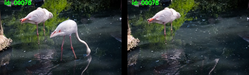

3.3 查看视频抠图结果
执行下面这段代码将看到视频抠图的结果,左侧视频是原视频,右侧视频是去除了一只火烈鸟目标之后的视频,可以看到目标抠除的效果是非常好的,完全不影响背景,仿佛这个目标在视频中就从来没有出现过一样。
注意:由于视频物体分割算法的发展时间较短,离实用场景还有一段距离,所以本案例的视频抠图demo使用的目标分割区域是人工标注的(存储位置在./video_object_segmention/Deep-Flow-Guided-Video-Inpainting/demo/masks),而不是上面的OSVOS算法输出的分割区域。
result_dir = './video_object_segmention/OSVOS-PyTorch/DAVIS_2016/JPEGImages/480p/Inpaint_Res/inpaint_res'
files.sort()
    time.sleep(0.02)
print('end')
end
