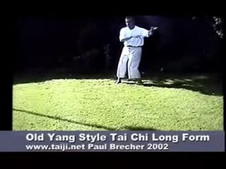

上一节课我们已经介绍了视频动作识别有HMDB51、UCF-101和Kinetics三个常用的数据集,本案例选用了UCF-101数据集的部分子集作为演示用数据集,接下来,我们播放一段UCF-101中的视频:
video_name = "./data/v_TaiChi_g01_c01.avi"
from IPython.display import clear_output, Image, display, HTML
import time
import cv2
import base64
import numpy as np
def arrayShow(img):
    _,ret = cv2.imencode('.jpg', img)
    return Image(data=ret)
cap = cv2.VideoCapture(video_name)
while True:
    try:
        clear_output(wait=True)
        ret, frame = cap.read()
        if ret:
            tmp = cv2.cvtColor(frame, cv2.COLOR_BGR2RGB)
            img = arrayShow(frame)
            display(img)
            time.sleep(0.05)
        else:
            break
    except KeyboardInterrupt:
        cap.release()
cap.release()

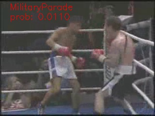

进行视频的预处理以及预测,将预测结果打印到画面中,最后进行播放。
# 加载所有的类别和编号
with open('./ucfTrainTestlist/classInd.txt', 'r') as f:
    class_names = f.readlines()
    f.close()
# 读取视频文件
video = './videos/v_Punch_g03_c01.avi'
cap = cv2.VideoCapture(video)
clip = []
# 将视频画面传入模型
while True:
    try:
        if ret:
            clip.append(cv2.resize(tmp, (171, 128)))
            # 每16帧进行一次预测
            if len(clip) == 16:
                inputs = np.array(clip).astype(np.float32)
                inputs = np.expand_dims(inputs, axis=0)
                inputs[..., 0] -= 99.9
                inputs[..., 1] -= 92.1
                inputs[..., 2] -= 82.6
                inputs[..., 0] /= 65.8
                inputs[..., 1] /= 62.3
                inputs[..., 2] /= 60.3
                inputs = inputs[:,:,8:120,30:142,:]
                inputs = np.transpose(inputs, (0, 2, 3, 1, 4))
                # 获得预测结果
                pred = model.predict(inputs)
                label = np.argmax(pred[0])
                # 将预测结果绘制到画面中
                cv2.putText(frame, class_names[label].split(' ')[-1].strip(), (20, 20),
                            cv2.FONT_HERSHEY_SIMPLEX, 0.6,
                            (0, 0, 255), 1)
                cv2.putText(frame, "prob: %.4f" % pred[0][label], (20, 40),
                            (0, 0, 255), 1)
                clip.pop(0)
            # 播放预测后的视频
            lines, columns, _ = frame.shape
            frame = cv2.resize(frame, (int(columns), int(lines)))
            display(img)
            time.sleep(0.02)
        else:
            break
    except:
        print(0)
cap.release()
