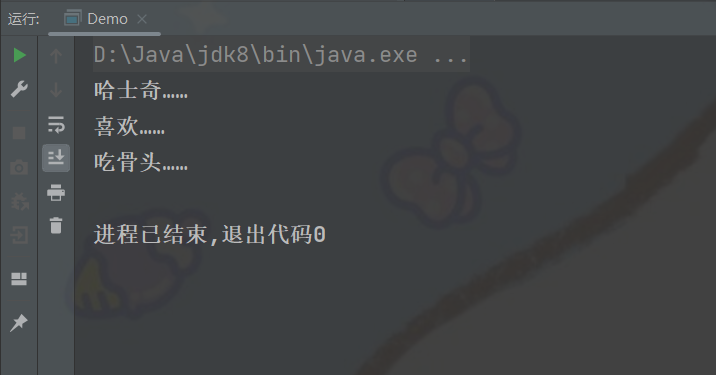

编写Demo类进行演示
public class Demo {
        Dog dog = new Dog();
        dog.setName("哈士奇……");
        System.out.println(dog.getName());
        dog.eat();
查看输出结果
