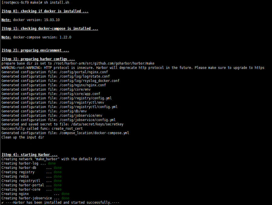

安装harbor
cd src/github.com/goharbor/harbor/make
cp harbor.yml.tmpl harbor.yml
配置harbor域名或相关配置,我这关闭https注释相关配置
vim harbor.yml
hostname: 190.XXX.123.97
https:
  # https port for harbor, default is 443
  #port: 443
  # The path of cert and key files for nginx
  #certificate: /your/certificate/path
  #private_key: /your/private/key/path
执行安装
sh install.sh

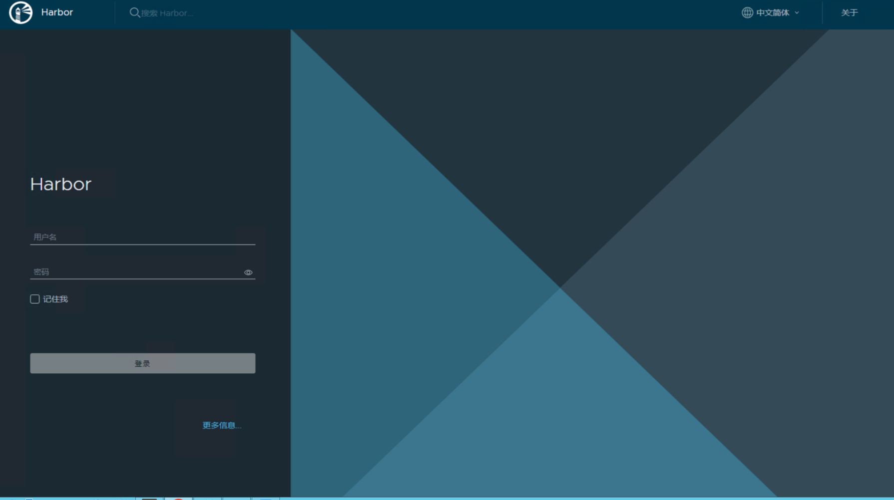

浏览器输入IP就能访问harbor了
至此教程结束
