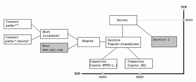

二、根据上面的配置文件,tomcat server的结构图如下:

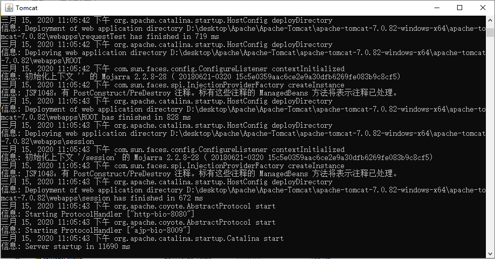

测试一下:
我们先启动tomcat服务器:
![Tomcat
15, 2020 11:05:42 T org. apache. catalina. startup. HostConfig deployDirectory
Deployment of web application directory D: 0. 82-windows-x64\apache-to
-7. 0. 82\webapps\requestTest has finished in 719 ms
cat
15, 2020 11:05:42 org. apache. catalina. startup. HostConfig deployDirectory
Deploying web application directory D: 0. 82-windows-x64\apache-tomcat
82\webapps\ROOT
15, 2020
com. sum. faces. config. ConfigureListener contextlnitialized
: " 2. 2. 8-28 ( 20180621-0320 15c5e0359aac6ce2e9a30dfb6269fe083b9c8cf5)
15, 2020
com. sum. faces. spi. InjectionFroviderFactory createlnstance
: JSF1048: PostConstruct/PreDestroy ManagedBeans
15, 2020 11:05:43 org. apache. catalina. startup. HostConfig deployDirectory
-7. 0. 82\webapps\ROOT has finished in 828 ms
cat
82 on
15, 2020
: ' /session
15, 2020
-7. 0. 82\webapps\session has finished in 672 ms
cat
15, 2020 11:05:43 org. apache. coyote. AbstractProtoc01 start
: Starting ProtocolHand1er C"http-bio-8080"]
: Starting ProtocolHand1er C' ajp-bio-8009"]
15, 2020 11:05:43 org. apache. catalina. startup. Catalina start
= * : Server startup in 11690 ms](https://fileserver.developer.huaweicloud.cn/FileServer/getFile/community/734/313/290/0001591410734313290.20250424144153.81127036774328755364893237126379:20261115190002:2415:3C4E3101666EB28C7F5FF58A51B8618A68B3E67C69E279B9DFDA23317D957342.png)
然后在cmd命令控制台上连接8005端口:telnet localhost 8005
然后输入:SHUTDOWN 按回车就会发现启动的tomcat被关闭了。

- Context把执行完的HttpServletResponse对象返回给Host
- Host把HttpServletResponse对象返回给Engine
- Engine把HttpServletRespongse对象返回给Connector
- Connector把HttpServletResponse对象返回给客户端。
