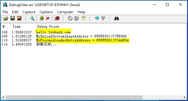

	ULONG64 MiUnloadSystemImageAddress = GetMiUnloadSystemImageAddress();
	DbgPrint("MiUnloadSystemImageAddress = %p \n", MiUnloadSystemImageAddress);
	MiProcessLoaderEntry MiProcessLoaderEntryAddress = GetMiProcessLoaderEntry(MiUnloadSystemImageAddress);
	DbgPrint("MiProcessLoaderEntryAddress = %p \n", (ULONG64)MiProcessLoaderEntryAddress);
	Driver->DriverUnload = UnDriver;
	return STATUS_SUCCESS;
运行驱动程序,即可得到MiProcessLoaderEntryAddress的内存地址。
得到内存地址之后,直接破坏掉自身驱动的入口地址等,即可实现隐藏自身。

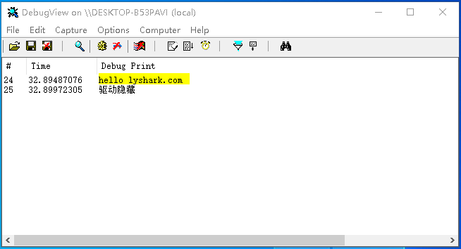

VOID Reinitialize(PDRIVER_OBJECT DriverObject, PVOID Context, ULONG Count)
	MiProcessLoaderEntry m_MiProcessLoaderEntry = NULL;
	ULONG *p = NULL;
	m_MiProcessLoaderEntry = GetMiProcessLoaderEntry(MiUnloadSystemImageAddress);
	if (m_MiProcessLoaderEntry == NULL)
		return;
	SupportSEH(DriverObject);
	m_MiProcessLoaderEntry(DriverObject->DriverSection, 0);
	InitInLoadOrderLinks((PLDR_DATA_TABLE_ENTRY)DriverObject->DriverSection);
	// 破坏驱动对象特征
	DriverObject->DriverSection = NULL;
	DriverObject->DriverStart = NULL;
	DriverObject->DriverSize = 0;
	DriverObject->DriverUnload = NULL;
	DriverObject->DriverInit = NULL;
	DriverObject->DeviceObject = NULL;
	DbgPrint("驱动隐藏 \n");
VOID UnDriver(PDRIVER_OBJECT driver)
  DbgPrint("卸载完成... \n");
NTSTATUS DriverEntry(IN PDRIVER_OBJECT Driver, PUNICODE_STRING RegistryPath)
	DbgPrint("hello lyshark.com \n");
	// 无痕隐藏
	IoRegisterDriverReinitialization(Driver, Reinitialize, NULL);
运行驱动程序,让后看到如下输出信息;
