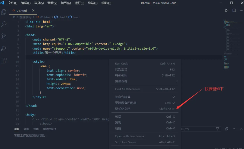

2. 快速格式化文档
在vscode中可以随便书写网页内容,最后可以右键格式化文档来使整个网页内容变得整齐且符合书写规范

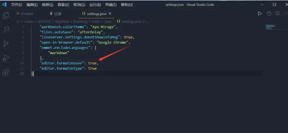

    "code-runner.defaultLanguage": "javascript",
    "workbench.colorTheme": "Ayu Mirage",
    "files.autoSave": "afterDelay",
    "liveServer.settings.donotShowInfoMsg": true,
    "open-in-browser.default": "Google Chrome",
    "emmet.excludeLanguages": [
        "markdown"
    "editor.formatOnSave": true,
    "editor.formatOnType": true
