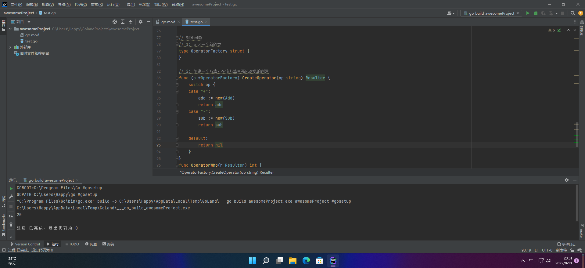

func main() {
	var operator OperatorFactory
	obj := operator.CreateOperator("-")
	b := obj.SetData(30, 10)
	if b {
		num := OperatorWho(obj)
		fmt.Println(num)
