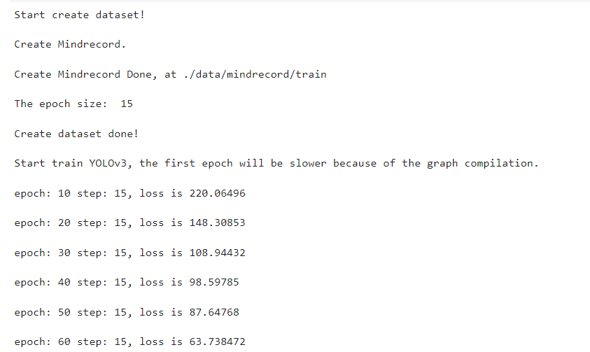

  • 本案例主要介绍使用MindSpore深度学习框架采用了基于Darknet-53的YOLOV3网络模型实现目标检测任务。
    实验步骤
  • 1. 定义数据处理相关函数
    以下代码用于定义相关数据集预处理的函数,如:生成Mindrecord文件,生成数据集对象等。

    6. 开始训练
  • 注意:这里的"train_url"为保存输出模型的地址,也可以在桶中创建文件夹,将模型保存到OBS中。
    # ------------yolov3 train -----------------------------
    cfg = edict({
        "distribute": False,
        "device_id": 0,
        "device_num": 1,
        "dataset_sink_mode": True,
        "lr": 0.001,
        "epoch_size": 60,
        "batch_size": 32,
        "loss_scale" : 1024,
        "pre_trained": None,
        "pre_trained_epoch_size":0,
        "ckpt_dir": "./ckpt",
        "save_checkpoint_epochs" :1,
        'keep_checkpoint_max': 1,
        "train_url": './output',   # 此处需要修改成自己桶地址
    if os.path.exists(cfg.ckpt_dir):
        shutil.rmtree(cfg.ckpt_dir)
    data_path = './data/'
    # if not os.path.exists(data_path):
    #     mox.file.copy_parallel(src_url=cfg.data_url, dst_url=data_path)
    mindrecord_dir_train = os.path.join(data_path,'mindrecord/train')
    print("Start create dataset!")
    # It will generate mindrecord file in args_opt.mindrecord_dir,and the file name is yolo.mindrecord.
    prefix = "yolo.mindrecord"
    cfg.mindrecord_file = os.path.join(mindrecord_dir_train, prefix)
    if os.path.exists(mindrecord_dir_train):
        shutil.rmtree(mindrecord_dir_train)
    image_dir = os.path.join(data_path, "train")
    if os.path.exists(mindrecord_dir_train) and os.listdir(mindrecord_dir_train):
        print('The mindrecord file had exists!')
    else:
        if not os.path.exists(mindrecord_dir_train):
            os.makedirs(mindrecord_dir_train)
        print("Create Mindrecord.")
        data_to_mindrecord_byte_image(image_dir, mindrecord_dir_train, prefix, 1)
        print("Create Mindrecord Done, at {}".format(mindrecord_dir_train))
        # if you need use mindrecord file next time, you can save them to yours obs.
        #mox.file.copy_parallel(src_url=args_opt.mindrecord_dir_train, dst_url=os.path.join(cfg.data_url,'mindspore/train')
    main(cfg)
    mox.file.copy_parallel(src_url=cfg.ckpt_dir, dst_url=cfg.train_url)

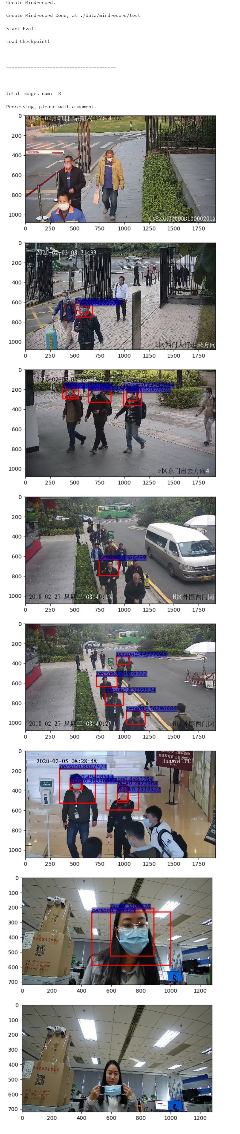

  • 7. 测试网络模型
    """Test for yolov3-resnet18"""
    import os
    import argparse
    import time
    from easydict import EasyDict as edict
    from PIL import Image
    import PIL
    import numpy as np
    import sys
    sys.path.insert(0,'./code/')                   # yours code path
    import moxing as mox
    from mindspore import context, Tensor
    from mindspore.train.serialization import load_checkpoint, load_param_into_net
    from src.yolov3 import yolov3_resnet18, YoloWithEval
    from src.dataset import create_yolo_dataset, data_to_mindrecord_byte_image
    from src.config import ConfigYOLOV3ResNet18
    from src.utils import metrics
    def apply_nms(all_boxes, all_scores, thres, max_boxes):
        """Apply NMS to bboxes."""
        x1 = all_boxes[:, 0]
        y1 = all_boxes[:, 1]
        x2 = all_boxes[:, 2]
        y2 = all_boxes[:, 3]
        areas = (x2 - x1 + 1) * (y2 - y1 + 1)
        order = all_scores.argsort()[::-1]
        keep = []
        while order.size > 0:
            i = order[0]
            keep.append(i)
            if len(keep) >= max_boxes:
                break
            xx1 = np.maximum(x1[i], x1[order[1:]])
            yy1 = np.maximum(y1[i], y1[order[1:]])
            xx2 = np.minimum(x2[i], x2[order[1:]])
            yy2 = np.minimum(y2[i], y2[order[1:]])
            w = np.maximum(0.0, xx2 - xx1 + 1)
            h = np.maximum(0.0, yy2 - yy1 + 1)
            inter = w * h
            ovr = inter / (areas[i] + areas[order[1:]] - inter)
            inds = np.where(ovr <= thres)[0]
            order = order[inds + 1]
        return keep
    def tobox(boxes, box_scores):
        """Calculate precision and recall of predicted bboxes."""
        config = ConfigYOLOV3ResNet18()
        num_classes = config.num_classes
        mask = box_scores >= config.obj_threshold
        boxes_ = []
        scores_ = []
        classes_ = []
        max_boxes = config.nms_max_num
        for c in range(num_classes):
            class_boxes = np.reshape(boxes, [-1, 4])[np.reshape(mask[:, c], [-1])]
            class_box_scores = np.reshape(box_scores[:, c], [-1])[np.reshape(mask[:, c], [-1])]
            nms_index = apply_nms(class_boxes, class_box_scores, config.nms_threshold, max_boxes)
            #nms_index = apply_nms(class_boxes, class_box_scores, 0.5, max_boxes)
            class_boxes = class_boxes[nms_index]
            class_box_scores = class_box_scores[nms_index]
            classes = np.ones_like(class_box_scores, 'int32') * c
            boxes_.append(class_boxes)
            scores_.append(class_box_scores)
            classes_.append(classes)
        boxes = np.concatenate(boxes_, axis=0)
        classes = np.concatenate(classes_, axis=0)
        scores = np.concatenate(scores_, axis=0)
        return boxes, classes, scores
    def yolo_eval(cfg):
        """Yolov3 evaluation."""
        ds = create_yolo_dataset(cfg.mindrecord_file, batch_size=1, is_training=False)
        net = yolov3_resnet18(config)
        eval_net = YoloWithEval(net, config)
        print("Load Checkpoint!")
        param_dict = load_checkpoint(cfg.ckpt_path)
        load_param_into_net(net, param_dict)
        eval_net.set_train(False)
        i = 1.
        total = ds.get_dataset_size()
        start = time.time()
        pred_data = []
        print("\n========================================\n")
        print("total images num: ", total)
        print("Processing, please wait a moment.")
        num_class={0:'person', 1: 'face', 2:'mask'}
        for data in ds.create_dict_iterator(output_numpy=True):
            img_np = data['image']
            image_shape = data['image_shape']
            # print("image_shape", image_shape)
            annotation = data['annotation']
            image_file = data['file']
            image_file = image_file.tostring().decode('ascii')
            output = eval_net(Tensor(img_np), Tensor(image_shape))
            for batch_idx in range(img_np.shape[0]):
                boxes = output[0].asnumpy()[batch_idx]
                box_scores = output[1].asnumpy()[batch_idx]
                image = img_np[batch_idx,...]
                boxes, classes, scores =tobox(boxes, box_scores)
                #print(classes)
                #print(scores)
                fig = plt.figure()   #相当于创建画板
                ax = fig.add_subplot(1,1,1)   #创建子图,相当于在画板中添加一个画纸,当然可创建多个画纸,具体由其中参数而定
                image_path = os.path.join(cfg.image_dir, image_file)
                f = Image.open(image_path)
                img_np = np.asarray(f ,dtype=np.float32)  #H,W,C格式
                ax.imshow(img_np.astype(np.uint8))  #当前画纸中画一个图片
                for box_index in range(boxes.shape[0]):
                    ymin=boxes[box_index][0]
                    xmin=boxes[box_index][1]
                    ymax=boxes[box_index][2]
                    xmax=boxes[box_index][3]
                    #print(xmin,ymin,xmax,ymax)
                    #添加方框,(xmin,ymin)表示左顶点坐标,(xmax-xmin),(ymax-ymin)表示方框长宽
                    ax.add_patch(plt.Rectangle((xmin,ymin),(xmax-xmin),(ymax-ymin),fill=False,edgecolor='red', linewidth=2))
                    #给方框加标注,xmin,ymin表示x,y坐标,其它相当于画笔属性
                    ax.text(xmin,ymin,s = str(num_class[classes[box_index]])+str(scores[box_index]),
                            style='italic',bbox={'facecolor': 'blue', 'alpha': 0.5, 'pad': 0})
                plt.show()
    # ---------------yolov3  test-------------------------
    cfg = edict({
        "device_id": 0,
        "ckpt_url": './output',
        "train_url": './testoutput'
    context.set_context(mode=context.GRAPH_MODE, device_target="Ascend", device_id=cfg.device_id)
    ckpt_path = './ckpt/'
    if not os.path.exists(ckpt_path):
        mox.file.copy_parallel(src_url=args_opt.ckpt_url, dst_url=ckpt_path)
    cfg.ckpt_path = os.path.join(ckpt_path, "yolov3-60_15.ckpt")
        mox.file.copy_parallel(src_url=data_url, dst_url=data_path)
    mindrecord_dir_test = os.path.join(data_path,'mindrecord/test')
    cfg.mindrecord_file = os.path.join(mindrecord_dir_test, prefix)
    cfg.image_dir = os.path.join(data_path, "test")
    if os.path.exists(mindrecord_dir_test) and os.listdir(mindrecord_dir_test):
    else:
        if not os.path.isdir(mindrecord_dir_test):
            os.makedirs(mindrecord_dir_test)
        data_to_mindrecord_byte_image(cfg.image_dir, mindrecord_dir_test, prefix, 1)
        print("Create Mindrecord Done, at {}".format(mindrecord_dir_test))
        #mox.file.copy_parallel(src_url=args_opt.mindrecord_dir_test, dst_url=os.path.join(cfg.data_url,'mindspore/test')
    print("Start Eval!")
    yolo_eval(cfg)
