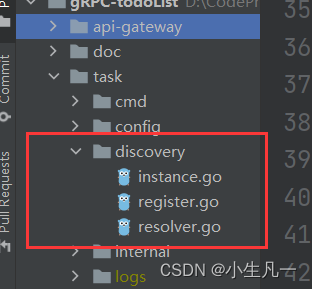

本文实战例子源码在 https://github.com/CocaineCong/gRPC-todoList 各个模块下的discovery中
