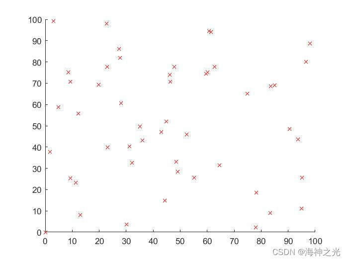

Map = 100 * rand(CityNum,X + Y);         % asix init 0-100 and set the

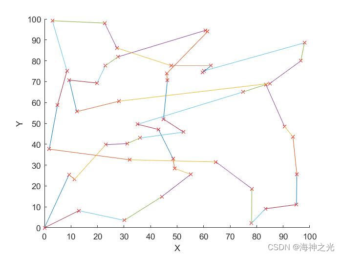

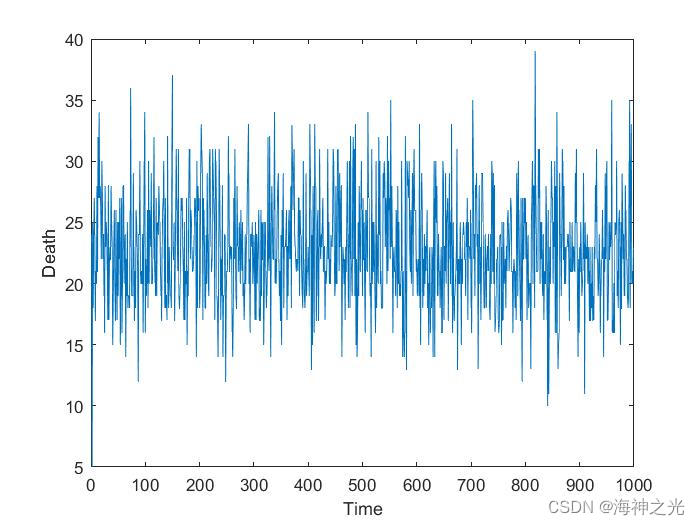

四、运行结果
