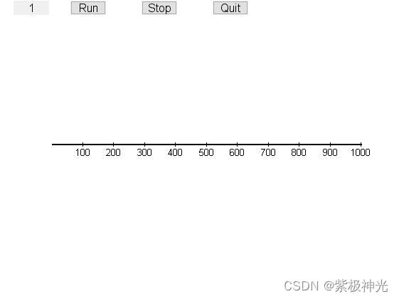

clc
clear;
%build the GUI
%define the plot button
plotbutton=uicontrol('style','pushbutton','string','Run', 'fontsize',12,'position',[100,400,50,20],'callback','run=1;');
%define the stop button
erasebutton=uicontrol('style','pushbutton','string','Stop','fontsize',12,'position',[200,400,50,20],'callback','freeze=1;');
%define the Quit button
quitbutton=uicontrol('style','pushbutton','string','Quit','fontsize',12,'position',[300,400,50,20],'callback','stop=1;close;');
number=uicontrol('style','text','string','1','fontsize',12,'position',[20,400,50,20]);
%CAsetup
n=1000; %数据初始化
z=zeros(1,n); %元胞个数
z=roadstart(z,200); %道路状态初始化,路段上随机分布200辆
cells=z;
vmax=5; %最大速度
v=speedstart(cells,vmax); %速度初始化x=1; %记录速度和车辆位置
x=1;
memor_cells=zeros(3600,n);
memor_v=zeros(3600,n);
imh=imshow(cells); %初始化图像白色有车,黑色空元胞
set(imh,'erasemode','none')
axis equal
axis tight
stop=0; %wait for a quit button push

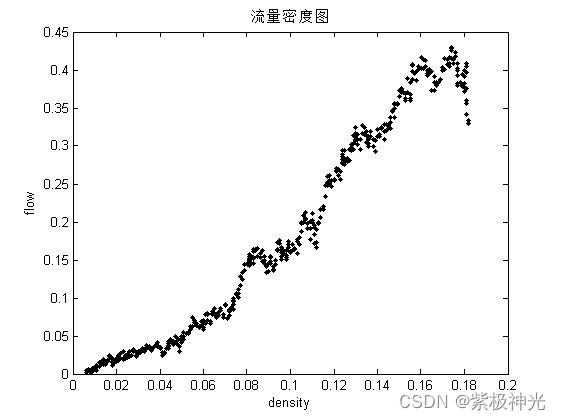

      for i=1:1:500
      density(i)=sum(memor_cells(i,:)>0)/1000;
      flow(i)=sum(memor_v(i,:))/1000;
      end
      figure(3)
      plot(density,flow,'k.');
      title('流量密度图')
      xlabel('density')
      ylabel('flow')
